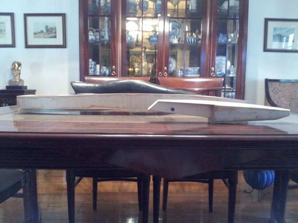

    ....Rigger is this one...

                    Today as the da for getting the wood waterproofed.....2 coats of polyester resin....
                    next week...primer and white paint.....the worst job is going to make the canopy....1 block of foram that is going to the CNC milling machine in morder to make the plug?...after that..Carbon fiber :-) .....it s just a pain in the .SS making things the way i want..... :-)
                    Next to it is the reborned DF 35 that came from the deep...... bits the Kursk...with a good ending..after 8 months.....
