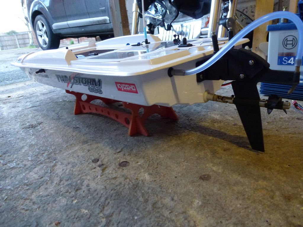

            i found that drilling out the stock water pickup did little to help so i drilled out and replaced with 4mm brass pipe which was bent slightly towards the prop, this worked MUCH better.
            As for grease i use Quicksilver marine grease available from loads of places.
            Prop up to a graupner 45mm carbon (but check temps) this made a big difference to mine and very cheap, you can probably see from the pic that i replaced the stock ball and cup joint with a stainless u-joint as the stock ones wear very quickly
