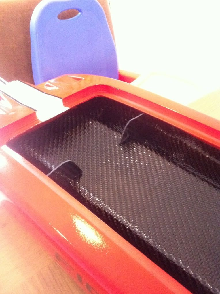

            will wires work ok when there is such as short distance between motor and strut (and therefore more angle?) ive read somewhere wire drives prefer a straight run?
            here is roughly where where the motors will be mounted, this is only my second build and 1st twin so this is all new!!

              they prefer less bend, so that would probably be too much.

                I built the same boat as a twin. It is sold now, so I cant measure where I put the motor mounts for you. From looking at your pic, I think you can use wire drives. My stuffing tubes had a bend in them. Never had any problems with my drive system. Here is a link to my build thread. Compare my motor mount location to yours. They look like they are placed close to the same location. Going by "eye" isnt accurate at all, but its the only thing to go by, by comparing pictures.
