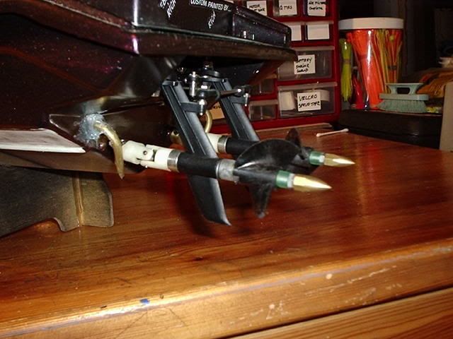

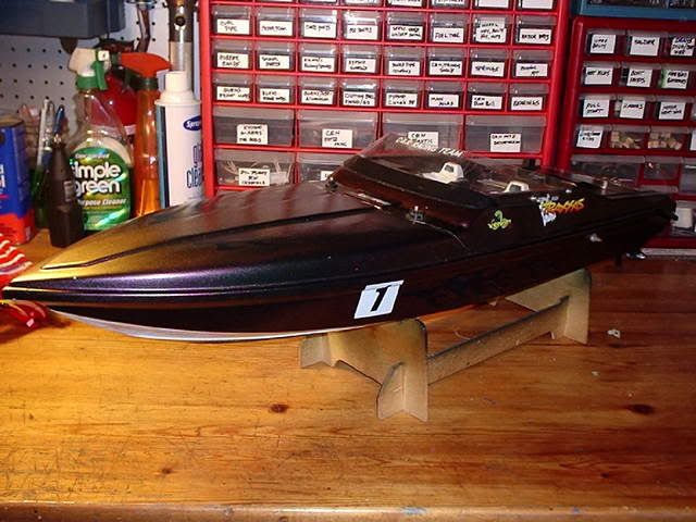

    This is my first post here, but I am not new to R/C or boats in general. I have a pretty old Villain IV that came with the original stinger combo with esc. I have since upgraded to twin 550's and 14.4 volt power. Added water cooling and these props.http://www.offshoreelectrics.com/pro...traxxaspropkit I have driven the boat a couple of times since getting it back after 5 years and a poor paint job and got it all trimmed out. Since the boat has been away, brushless motors have taken over the world and I plan on installing a twin brushless system over the winter.. My questions are as follows: Can I use those props that I have with the higher revving brushless motors and without converting to a single brushless setup, has does anyone have experience doing this setup or have a link to a successful one. I don't want to spend a fortune on the boat as I only use it occasionally and don't want to convert it completely..I have quite a few too many r/c's according to the wife and don't want to get her any more upset than I have to..
    here are a couple of pics of the boat just after I got it back from the person I sold it to 5 years before...
