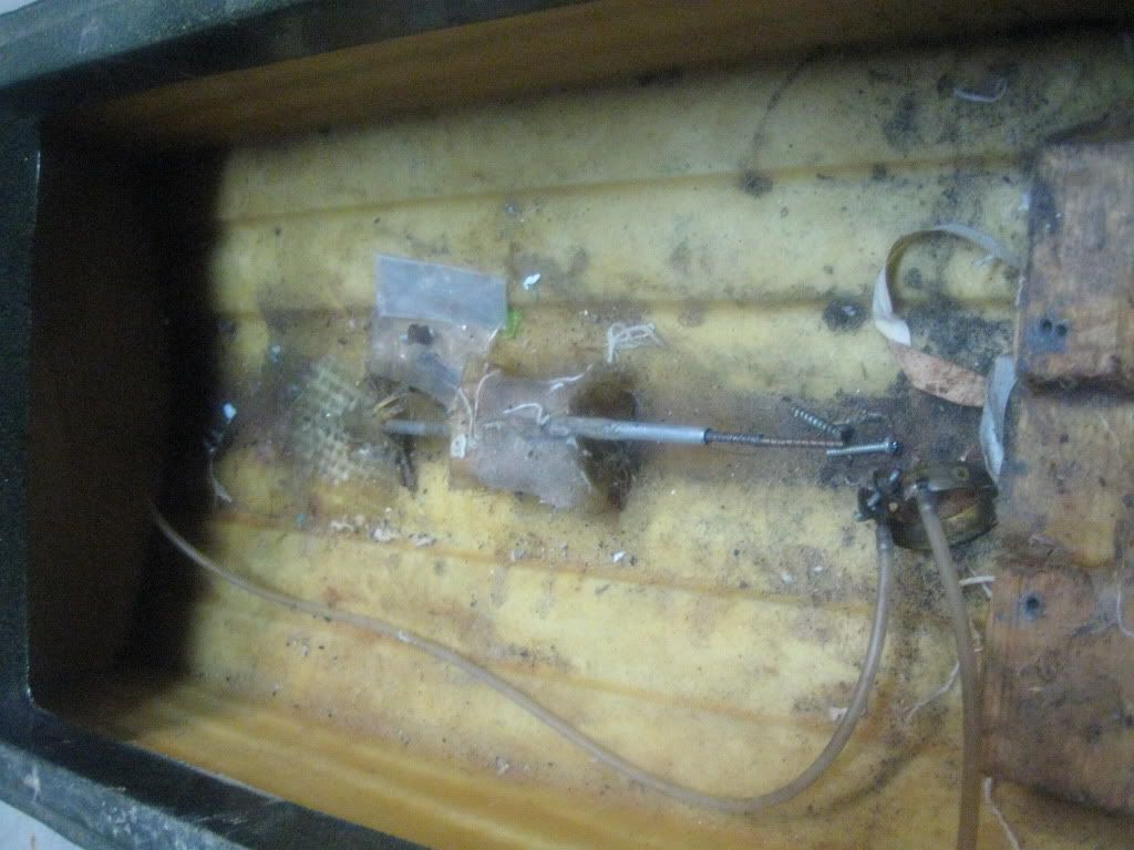

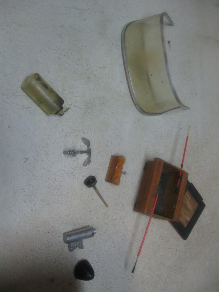

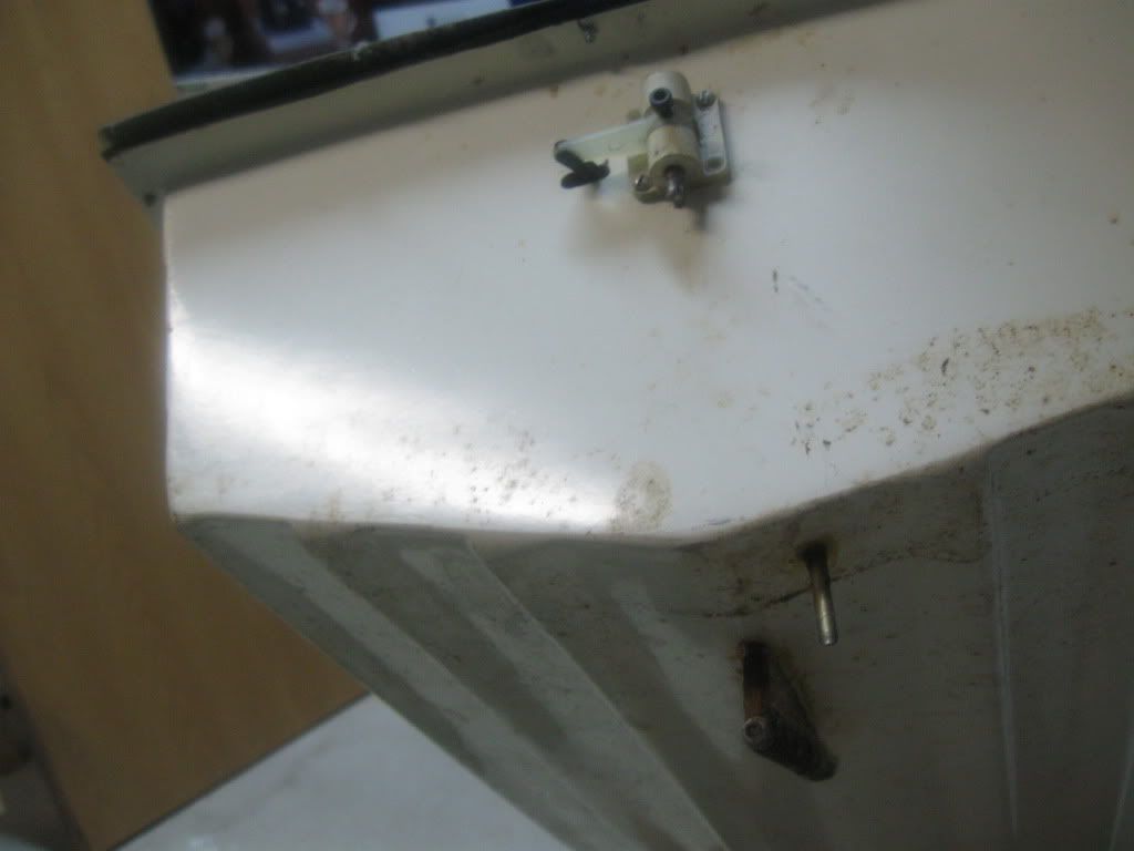

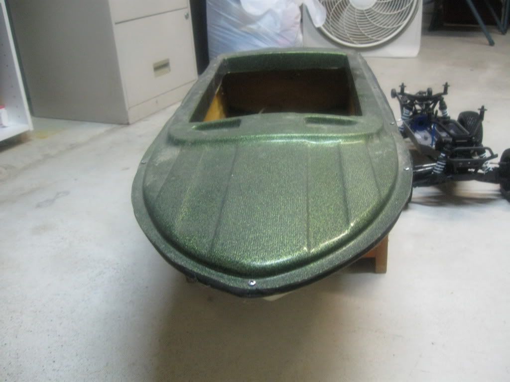

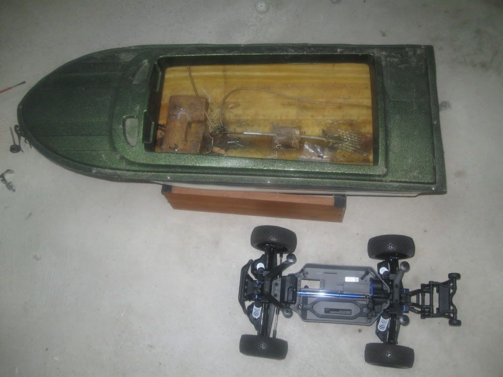

    A few years ago my grandpa had given me this boat. Its big, about 921mm long. About a year and a half ago i got into rc trucks and cars and decided i wanted to get this boat up and running. This Christmas, with the help of my parents i think i will have enough money to complete it. But i am going to need some help from you guys to decide all of what i need. I beleive it was originally a nitro boat because i found several glow plugs inside and a fuel tank with gelled nitro in it. If it is needed i can make metal motor mounts etc. So far this is the ESC and Motor i will be running http://www.hobbypartz.com/07e-c-seaking-80a-hv.html http://www.hobbypartz.com/96m811-3674--1300kv.html
    . The hull does not have a top for it but one will be made after it is repainted. Here are some pics, post any comments you have. I will be looking around the forum to try and understand boats a little more, thanks!
    Next to the Stampede 4x4

    How many cells will you be running it with?

      The motor can handle 10 and the esc, 12. I will try 10 but if the motor seems to be getting to hot ill bump it down to 8
      • Boaterguy
        • 1760
        10S lipo? that's 52k rpm unloaded, aim for about 25-35k unloaded.
        • Basstronics
          • Jun 2008
          • 2345
          subsurface drive...
          You might want to consider putting all new hardware on the boat. 3/16" prop shaft and .150 cable should work for you given the motor selection. However if that boat is truly 39" long then a 3674 isnt going to cut the mustard. Think 4074 minimum. Maybe even the 4082.
          Also that ESC probably wont hold out. Just my opinion. Im still learning but one thing I do know, go bigger on the ESC. No fun to cook an ESC or overheat while on the water. Its quite embarrassing.
          If you decide to maintain that subsurface drive I think you will need to be less than the 30K rpm range.

                  Depends on what you want to do. To be honest its an old boat, old design, old technology. Sure we can get you up and running but I extremely doubt it will be as fast or handle as good as a new boat would. Furthermore it sounds like money is an issue. Big boats are not cheap to run. So you got two things working against you here.
