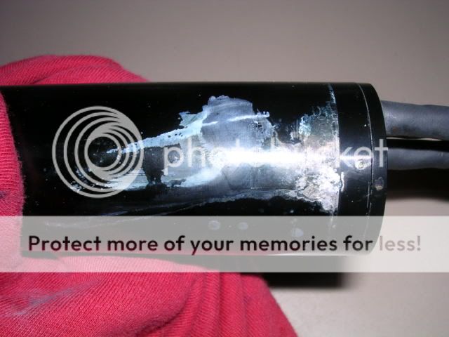

            I know alot of you guys have had lots of fun in salt water. And I know you guys are diligent, using preventive maintenance to negate the effects of salt water corrosion but I would like to show you some pictures of a motor I purchased off an OSE member who ran his in brackish/salt water. He did state this to me before I purchased the motor and he stated as you he flushed his cooling system with freah water, then used compressed air to blow out the lines and went further spraying corrosion x inside the lines and devices.
            Even after all that this is what I disvovered after disassembling the motor. The motor is a 1521 and not junk. But there is considerable damage to the anodizing. Its still a good motor. But take a lesson. Salt will do its job. Just cause you dont see it doesnt mean corrosion is not happening.

                I have to run on salt water all the time,My advice is if you dont have to dont.You can clean the boat,flush the system with fresh water & lube but you will not stop the corrosion setting in,You can minimise it by cleaning & lubing but you wont stop it.It starts as soon as you put the boat in the water.Thats a very good example that John has high lighted on the motor,As soon as you switch the motor off the heat that is in the motor & esc evaporates the water & your left with pure salt in their corroding things. Even after flushing through & lubing religously If to take off cooling lines after a while you will find salt deposites in all the fittings on the rudder,motor,esc etc. Poke a piece of wire down in the esc cooling plate & see all the salt that comes out after a while. I can run a polished prop & after a couple of hours when i leave the prop has turned a dullish red colour.Martin.
