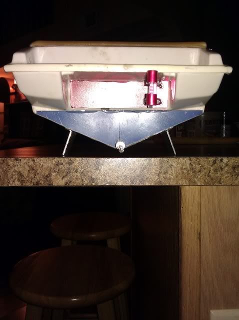

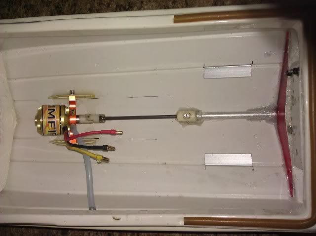

                      well i have been busy just unable to post progress. i have gutted the hull, epoxied in the motor mount and stuffing tube. doubled the transom (actually tripled, i sandwiched it.), mounted the rudder (proboat bj26 nitro rudder) and mounted the servo (hot glued for now)
                      im getting the prop shaft threaded today and it should be rtr by thursday!.
                      o btw Make-a-Wake i kinda borrowed your turn fin idea, hope you dont mind.

                        first run on the lake was successful! i need a new motor now though. the outrunner was only rated for 4s lipo and it gave its all on 6s but it smells cooked.... i didnt get to gps it before the U-joint blew up but i have a flex coupler on the way. gonna add trim tabs and see if i can get her to level out.
                        still trying to get it to track straight. what prop would you run on this?
