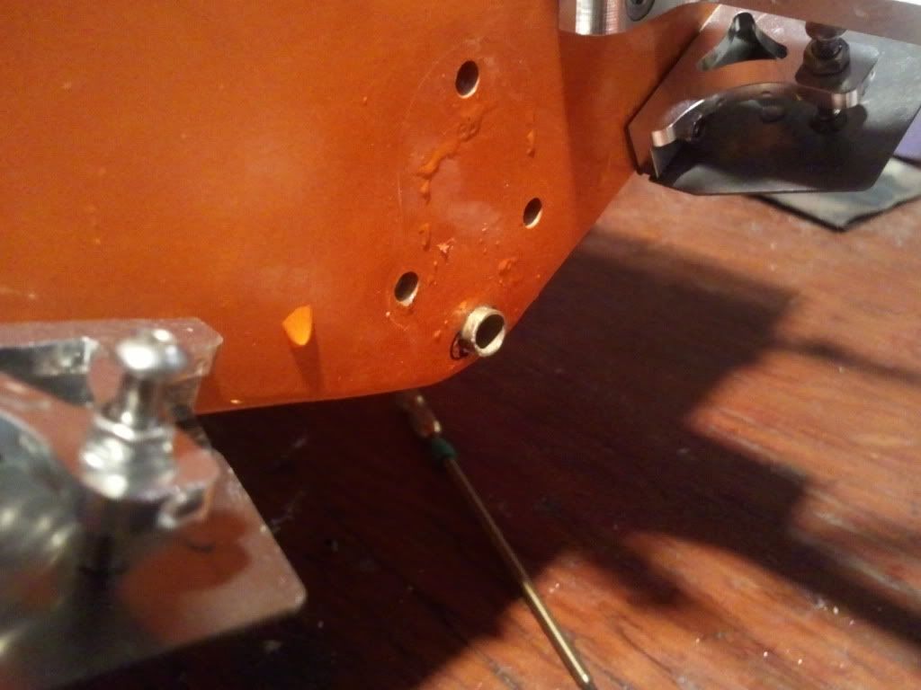

    Ok well I think I found the problem. I have a speedmaster strut I pulled it off and the stuffing tube does not go inside of the strut. Is it supposed to with this particular strut?

          Can you show a picture with the cable in the boat? And with the stinger on.

            The stuffing tube in your picture is correctly spaced; it should enter the transom plate but not the stinger, otherwise you'd lose the adjustability. If you run teflon, the teflon can enter the stinger since it can flex to allow adjustments. There should be an O-ring between the plate and stinger which helps keep water from creeping in. You can use a vacuum cap or a piece of silicone tubing to seal the motor end of the cable to the stuffing tube, and marine grease on the cable also helps. BTW if you go wire drive, you'll likely need to go smaller diameter on the stuffing tube.

              Yes it is wire drive an there is no teflon liner in it. There is a rubber oring which may be worn a little and not creating a good seal. I've never had thisproblem with any of my boats before. I did pull the deck and the stuffing tube is almost flat which makes me wonder if that's part of the problem

                Problem solved. I ended up moving the stuffing tube into the strut and it no longer leaks. Granted ill lose some adjustmet but to me its worth it. I can still make minor adjustments just nothing drastic
