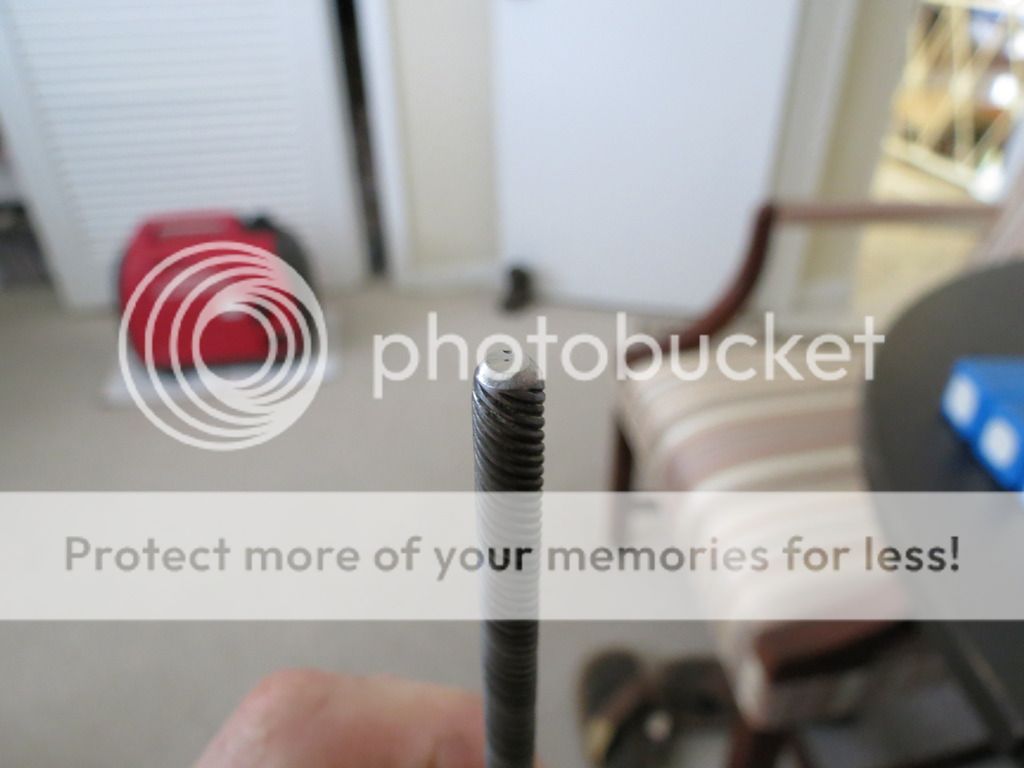

                      I struggled with this for a while and then i figured it out and its so easy.first clean the end of the cable about an inch or so down with 91%rubbing alcohol.next take your dremel with a small wire cleaning bit and use it to clean and scuff the end of the flex cable,make sure to do this thoroughly till the cable is very clean and scuffed dont worry you wont hurt cable.now clean the cable again with alcohol.now time to solder i use metal work acid core solder and standard paste flux.dip the cable in flux and coat it liberally you want a good amount of flux on there.next fire upp your propane torch and get about 3-4in of solder ready and heat the cable in the flame till the flux liqufies 6-8seconds now keep it in flame and start spreading on the solder till it melts and coats the flex,then remove from flame and carefully wipe it and your done.good luck
                      • brushlessfreak
                        • May 2012
                        • 21
                        #41
                        Take your dremel with a wire wheel and thoroughly clean the cable end,then clean with 91%alcohol.i use a propane torch,metal work "acid core"solder readily available at lowes-etc and regular paste flux not rosin core elec flux.once the cable end is cleaned and shiny from the wire wheel apply a very liberal amount of flux to the end,dont be skimpy,and fire up the torch.pull out a 3in line of solder and heat the cable for few seconds till flux melts and keep in flame and start to sort of brush the solder on while slowly spinning the cable. Once the solder melts and has covered the end of the cable i wipe it carefully with a rag to smooth out the solder while its still hot and melted.thats all there is to it,the solder gives the motor coupler something to bite on when you tighten it.keep trying you will get it.remember clean surface and plenty of flux..good luck

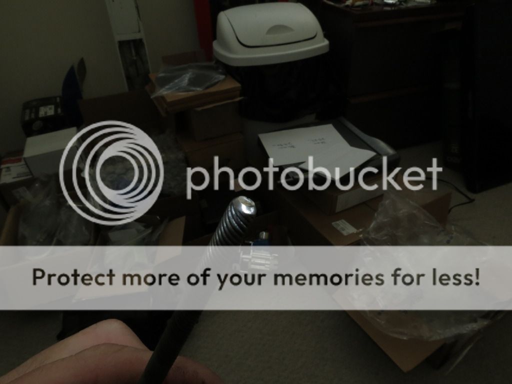

                          I know this is an old thread, but I wanted to share my method of soldering flex cable. The crucible method. I've been just buying brazed cable, but I use this method to close up the loose ends after cutting the cable to length.

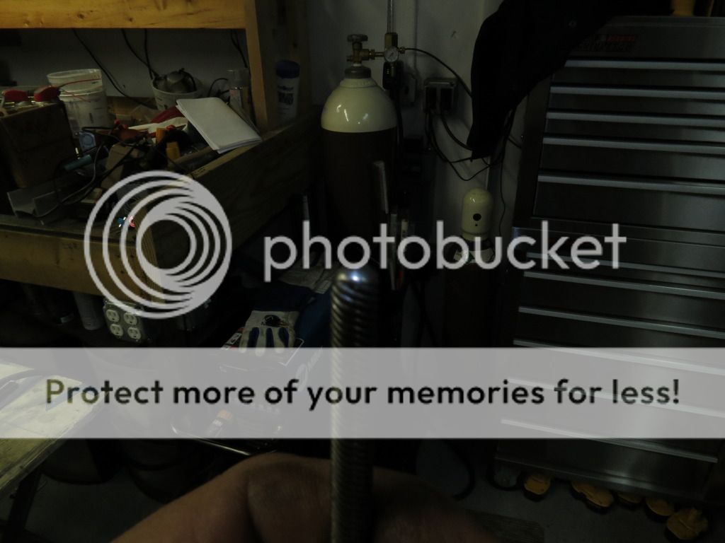

                              First you cut it nice and true. https://youtu.be/jW-VSCDe-_E
                              Then tig weld up the end to keep the center core locked in place and regrind the end.
