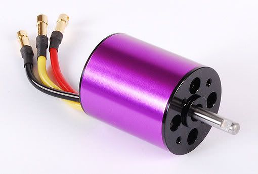

    Has anyone tried this motor in a hydro?
    HXT 36-56 2700kv Brushless Inrunner (WaterCooled)
    Kv: 2700rpm/v
    Required ESC: 80A
    Voltage Range: 10-18v
    No Load Current: 4.9A
    Max Load: 68A
    Max Power: 475W/60S
    Weight: 317g
    Shaft: 5mm
    Standard size mounting holes enable the motor to be installed in a large range of motor mounts.
    Motor has a built in water jacket.
    Price - $45.00

          The small picture in the picture shows the water inlet and outlet on the end with the wires.

            I also think it's one of their hybrid enclosed outrunners. The endbell looks just like one.
            • ReddyWatts
              • 1711
              I may purchase one to test, since no one else has tried one, but not sure about it being an outrunner.

                This is the motor I think it looks like. They may just use the same cans but it does look real close.
                This is a new type of motor, with an outrunner system built inside an inrunner case. Giving the performance and torque of an outrunner with the no moving external parts ease of use of an inrunner.
                Spec.
                Length: 42mm
                Diameter: 36mm
                Shaft: 5mm
                Weight: 119g
                Kv: 2900rpm/V
                Power: 710W+
                Resistance: 29ohm
                ESC Required: 36A or higher.

                  hmmmm...... interesting. Is that an HXT motor?

                    That looks like the BJ and SV Motor just different color cans same wire material also

                      Why yes it is Mr Watts. Page 1 of the outrunner directory.

                        It would not bother me if it was an outrunner as long as it does not get too hot for my application.

                            I also like the look of those outrunners in an enclosed can but as with all outrunners, they can be a bit tricky to keep cool. I have had success with running a cooling tube on the motor mount to keep the stator cool, you will find that the drum still gets warm though. I don't think that putting a cooling can on it will help either. Something for somebody to try??
