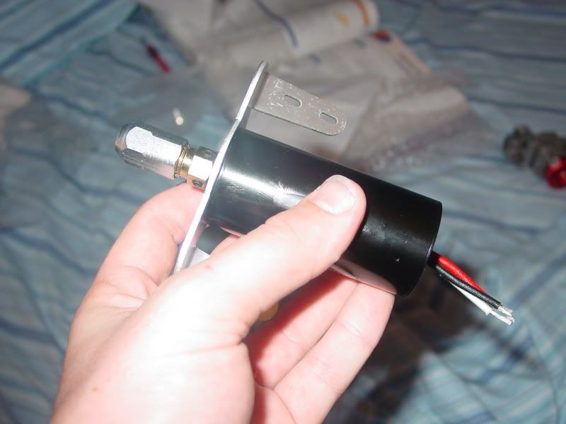

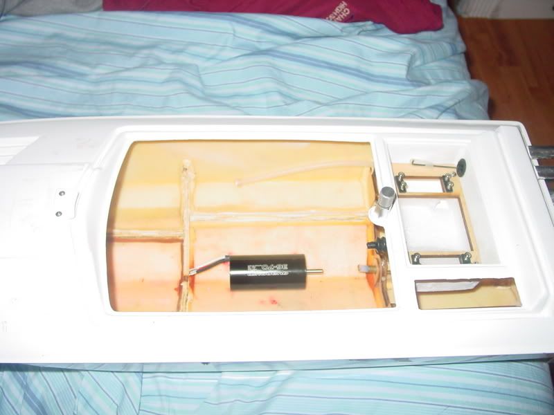

    Im in the middle of a conversion using the SW36 hull (the old nitro in it just never ran right) and so far i have the motor installed, the esc is ready to be put in, and im only a few bucks away from buying the batt's.
    it uses a Quantam 36x70 BL motor and a welgard 100amp esc. It will be powered by 24 IB3600 cells.
    some pics:

                    should i replace the current motor with a feigao 14XL? ive been hearing bad things about it, not just from Steven, but on a bunch of other forums..
                    also, ive been told that i should grind out a small flat spot in the shaft to give the coupler's set screws a better grip, but ive been having trouble....the shaft it alomost indestrictable..ive been trying to grind out a flat spot with a file for hours and have been pressing on the shaft so hard when i do im afraid ill bend it...and so far, the most ive done is scratched it...the coupler has two set screws at around 120* from eachother, would that be enough to hold on to the shaft or will it just spin? i know people who dont put a flat spot on and the coupler never comes loose on em and they use high power setups, where others couplers wont even stay on the shaft longer than 2 second nless they ave a flat spot...im kind cautios about going at it with a dremel too.....is there another way to cut a flat spot in the shaft

                      What type of file are you using? Try a mill (bastard) file. Designed to be used in one direction only. We use them to sharpen concrete boring bits, and they should work on your shaft. In fact, I used one to file down a DeWalt cordless motor shaft, so I could get it to fit into a 5mm coupler. I powered the motor up and pressed the file against it, and shaved it down in just a few seconds.

                            i found a big file a filed away and eventually i got a small flat spot...i hope it holds..
