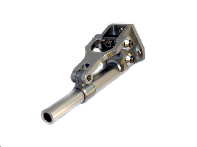

                The z-drive is really big, 183mm long, so prop would be far from transon, is this ok?
                THe lenkstrut drive that wd200 sells also should be better for 57" hull? -it is shorter.

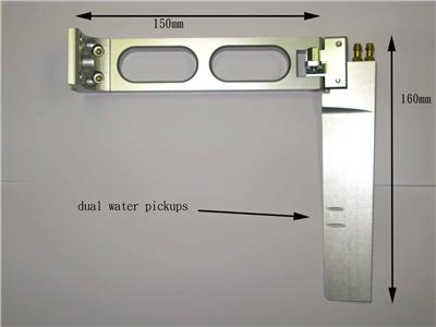

                And is there any scale looking rudders out there? -was thinking two of these struts
                And then one rudder to the center, or one next to both drives. -would 1 centered rudder work? -if it is further then the props from transom it should ,right?
                Cant find any rudders that are symmetrical,(when looking from behind the transom the rudder would be bolted left and right side.) -so it would look the same no matter witch side of the hull you would look at it.
                (not like this that have only bolts on the left side of the bracket.
                -Or can the bracket/rudder be flipped over, so I would have one that has bolts on left and one that has them on the right side? -! never thought that...
                (trying to make this to look really nice)
                Any ideas welcome!

                  -The steerable strut"lenkstrut" would be nice, but I was thinking what the flex does when turning...-fe uses firm collet at motor, but gas engines have square flex/collet so the flex can move a bit. So could this lenkstrut then not work with fe? -dont want the prop shaft move closer /further to/from transom when driving/turning!
                  No one is having any thoughts about scale/nice looking rudders/struts?
