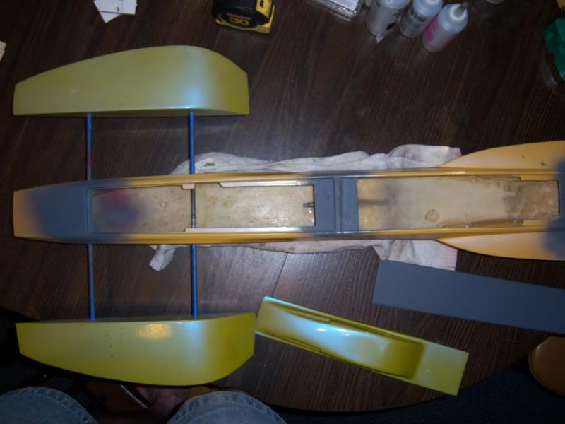

          I do own a 1520 1y . It looks like I may be looking for a 1527 1y if that dont work. Im kinda on a budget so it may be a while. I'll send some pics when my lady gets home Doug. The hull weighs 4lbs 1oz with hardware motor mount and servo raptor. Thanks for the input guys your help is much appreciated. Jason
          • noodler
            • 33

              Keep posting pics of the build so we can get a look at that Bad Baby!

                  The builder him self. Robert what did it look like before I got it im curious to know? I cant wait to get it going! Mr rumrunner its a castle 1520 1y not a Neu. Im gona try 2 2500mah 6s paks just need pick them up from friend to test fit.

                      I'll post some pics for ya tonight.

                          Here ya go Jason. The pics of her when I first started on her. Had to do a little glassing for the canopy and rear deck lid.....

                            Thanks Robert, the boat turned out great as far as i can tell. thanks again.
