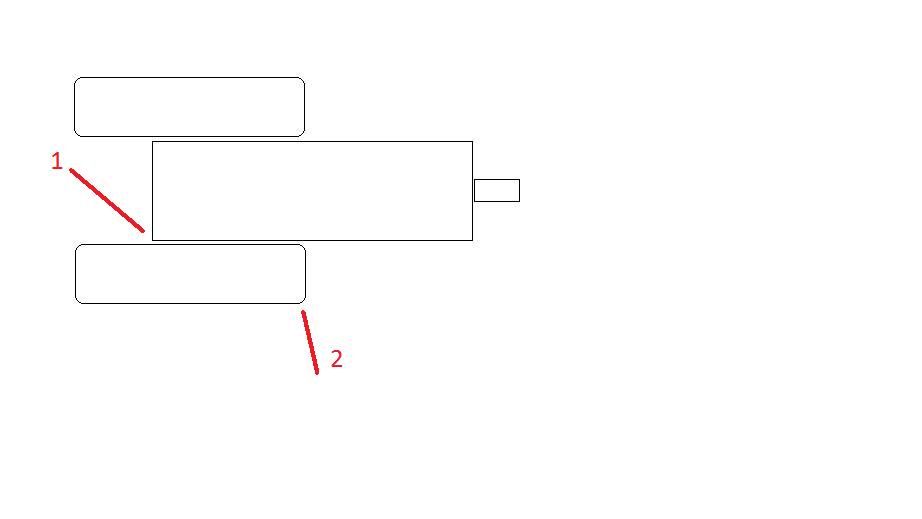

                    OK...I think I may be getting a little confused with sponson placement LOL. COG is 1" behind #1 or #2?

                      behind number 2

                        yes, number 2
