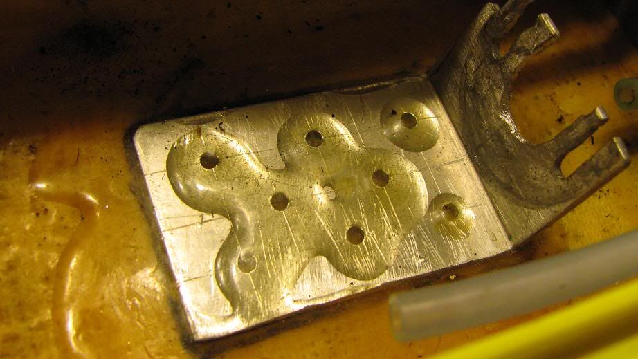

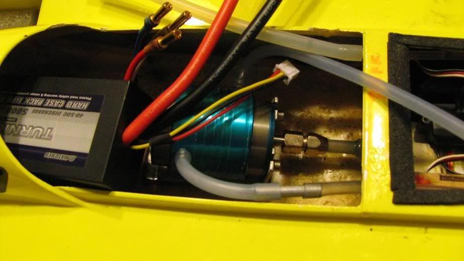

    Hey guys,
    I just picked up a Miss Llumar and while I'm awaiting for my 4074 to come in the mail, I decided to stick a BJ26 1500KV in it for kicks....ran good but I then noticed that space is very limited....I don't think a 4074 or a 9xl will fit with my batteries up front....they barely fit with the BJ26 motor.....is it possible to move an epoxied motor mount?

    Just heat it up with a heat gun or soldering iron and it will soften the bond and come loose.

      i have used a hair dryer before and it definately gets hot enough to break it loose..
