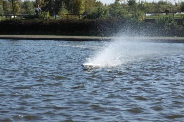

    Hey guys, this is my Titan 29, which was built and then shipped over to me in the UK by MadMikePags ().
    The build is exceptional and it runs as sweet as a nut. Only thing is, it runs so well, that I think it could handle a bit more speed.
    I run it on a Nemesis 10xl, with a Hydra 120 esc and on 14.8v via two 3000mah 7.4v packs. I can't remember the prop size, as the PM that Mike sent me was via my old user name, which I couldn't access, so I have had to start a new account.
    Anyways, I just wondered what my options would be. I have heard that I could simply use a 6s pack, but surely this would push the ESC to its limit??
    Any comments or advice would be welcome!!
    (Oh, and a huge thanks to Mike for the awesome build, and for the effort of getting it sent all the way to me in the UK. Cheers!!)

              After it taking nearly 4 hours to upload the HD content......
              A short vid with its current set-up. I think I actually managed to give it some throttle a few times, but the wind was really strong and the boat is too light in this form.
