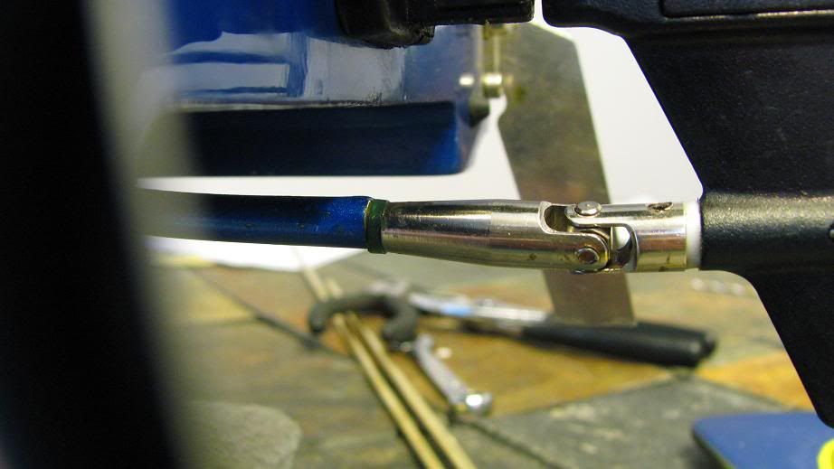

    Hey guys,
    I know this has probably been covered a few times...but I'm really having a hard time keeping water out of my hull Here's a quick pick of the culprit...
    If you guys could shoot me your quick fix build ideas...much appreciated

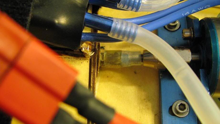

              Can you post of picture of what the stuffing tube connection to the strut looks like? Also, what kind of bearing/bushing are you using in the strut?
              • syncronized77
                • Jun 2010
                • 277
                Do you mean this....I just recently put a small peice of fuel tubing between the stuffing tube and the strut
                And is this what everyone else does??
                  That is exactly what most of us do. You hit it right on the head. Tough to describe. A picture speaks volumes!

                    So this little piece of tubing is well greased so it does not weld itself to the flex tube ?
                    • Rumdog
                      • 6453
                      It is just cooling line tubing. How hot does your stuffing tube get?!

                          Here's one that always gets missed...... Be sure to grease between the stuffing tube and the teflon tube. Water can sometimes seep between the two.
