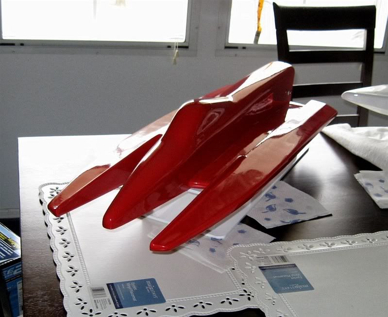

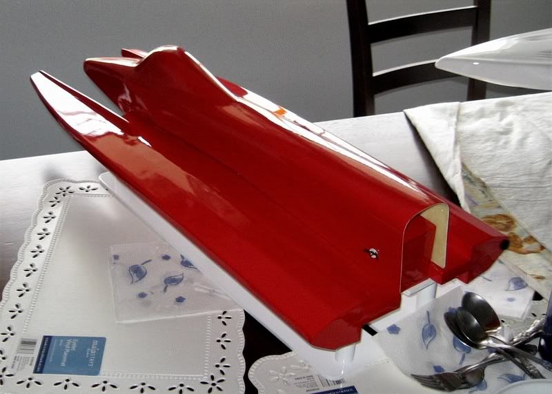

                        I have saw enough.... I need one. I just got the hull its red (awsome), ordered the lower unit and a few other things I should need. Some of the coversion looks not to bad but some looks a little tough. Darin, you made it look easy. I am looking forward to this boat.
