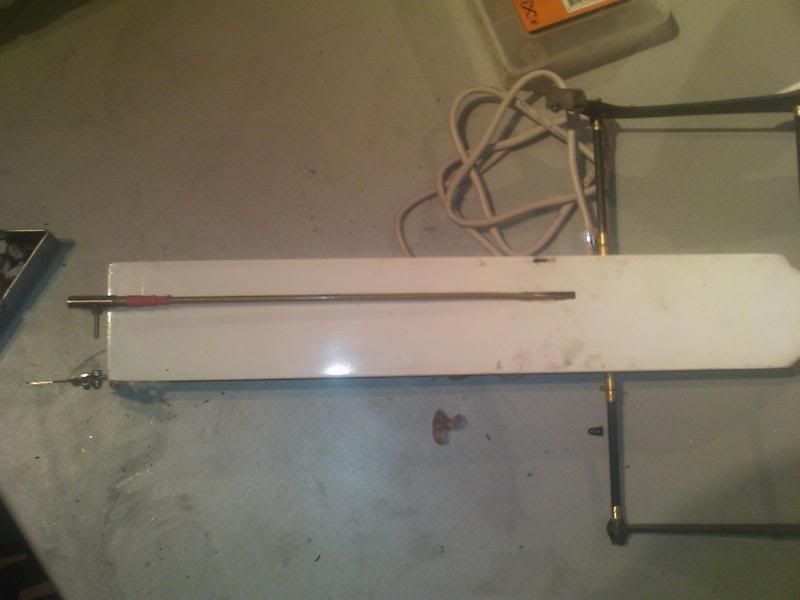

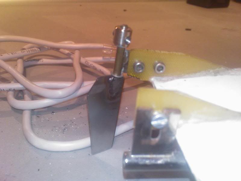

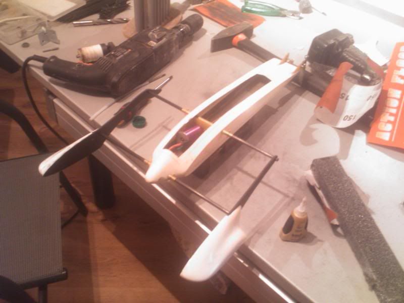

                  i have made the rudder and turnfin.
                  the rudder bracked has to be made and the blades have to be sharpend, but it is the beginning.
                  its just quick made hw so far, it needs to be polished for show :P
                  here are some pictures
                  an overview of what i have done today.
                  the booms are not gleued in yet.
                  i hope to make fast but good progress

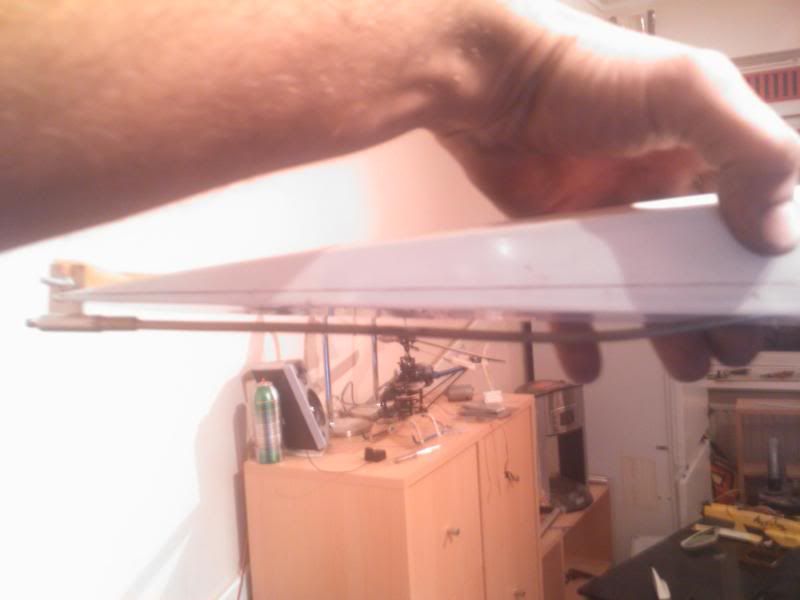

                        here 2 pics of what i did earlyer .
                        overvieuw of the hull
                        the shaft

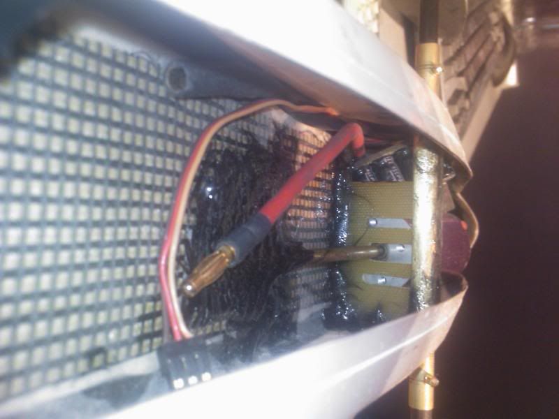

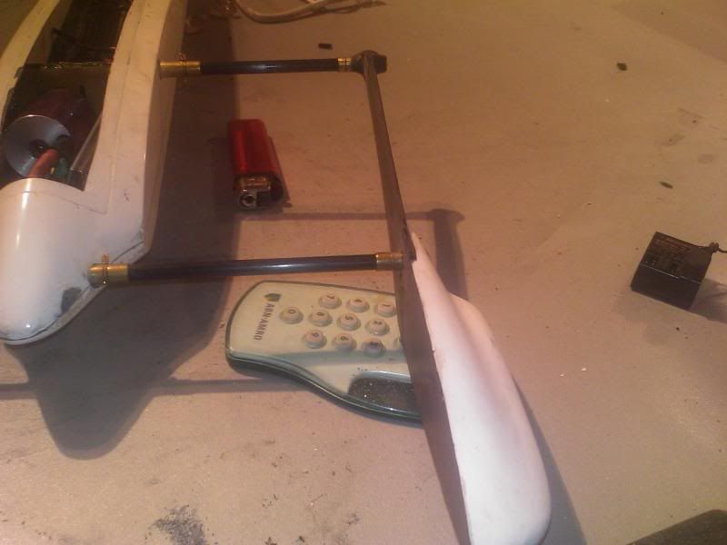

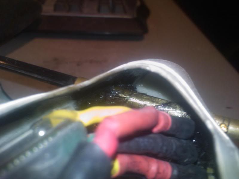

                          here some new pics of my progress.
                          i weight the hull with allmost everything in it and i think i come at 650 to 700grams of weight in total, including the battery.

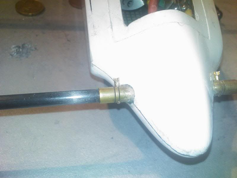

                          sponsons are reinforced at the bottom with carbon fibre, and glued to 3mm carbon plates.
                          booms are fixed in brass tubes and held in place witch some 2mm gold plugs.
                          turnfin mounted with 4mm stainless bolts (thread is in the carbon plate)
                          motormount glued in with some carbon fibre mixture and shaft with carbon fibre cloth.
                          only problem now is the servo mount...
                          i got very little hight for mounting the servo, so i need to figure that out...
                          anyone can handle me some pictures of other rocker riggers?
                          i cant find any info or data of this thing..

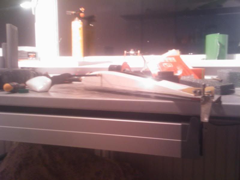

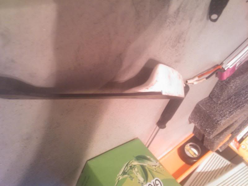

                            here some pictures of this weekend.
