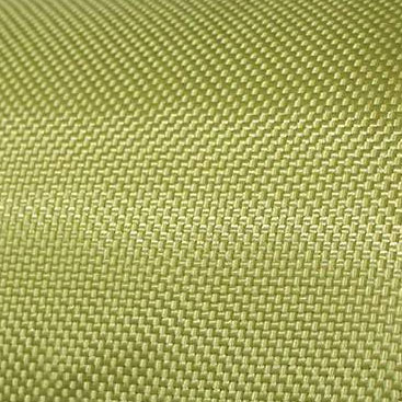

              Don't use as much epoxy as you see in the pic already posted, it only adds weight, and NO
              strenght !
              btw : carbon-only is cosmetic-only !
              The better way is using a hybrid-cloth/fabric. A mixture of carbon and kevlar.
              Twill weave or atlas weave are the best types of weave/cloth.
              Pic of my current build : atlas hybrid cloth.

                carbon adds significant strength and rigidity...it's just overkill IMO. that cloth in the picture is beyond wetted out.
                heating epoxy will reduce its cure time, so you better work fast if that's your plan.
                tough to find a good FG/kevlar hybrid nowadays...carbon should suffice, and you dont need major weight. 4oz or so should be fine. using a paint brush i'd brush the hull, maybe hit it with a hairdryer till it gets tacky, then lay your wetted cloth.
                after all is said and done, do not sand your FG. it will eat away at the fibers and compramise all that strength you were going for. it is much more expensive than FG, and imo isn't really needed unless you're breaking speed records or you have a thin piece that needs a lot of strength (like a MMT or a rigger).
                anyway good luck. post pictures. (IMO you should be looking at 1k-3k cloth. and be prepared to shell out 18-30 bucks for quality carbon per sq yd).

                          call them. they're a lot more in-depth on the phone. not knocking any other source, i've used many sources for composites for rocketry, and soller has always delivered the best quality at the best price. the hybrid will look awesome on the bottom of a boat, and will be sufficiently strong for anything that comes it's way. (you'll probably be able to jump up and down on it. i built a 3" rocket out of their hybrid tubing, 2 layers of hybrid cloth, 2 layers of hybrid tape for the base of the fins, and im 230lbs and could stand on the airframe with no ill effects.

                            r1demon :
                            why using a hybrid cloth in a rocket ?
                            The "forces" working in on a rocket don't come in an angle.
                            Kevlar has no strenght in the lenght of the fibres.
                            IMO carbon only is enough for a rocket.
                            Or do you use a hybrid because of the landing of the rocket ?
