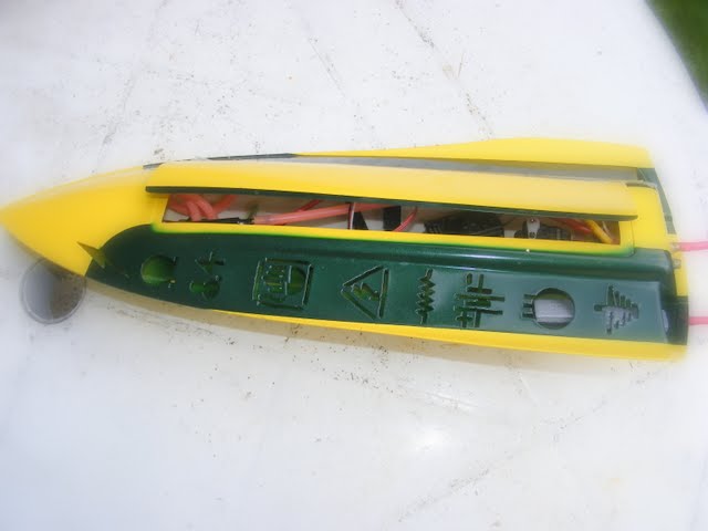

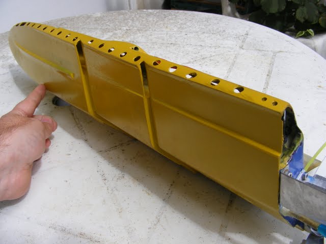

                Then you would HATE my Tenshock Mini Eco and Mono1, as seen the Pics.

                  WOW! Thats alotta holes!

                    I will say it too. WOW...so many holes there is not much hull left...chuckle Bet it flips over very quick.
                      How fast will those roll back over?

                          The Mono is very fast, just a couple of seconds i lose about 1/3rd of a lap to a capsize, the mini eco is slower 4 seconds maybe, needs more holes in the bottom but has no steps to hide them in and runs on a smaller course a little over half a lap for this one.
                          From what I gather being of stepped design the mono would only be legal for offshore and hydro over there not mono racing, only really suitable for hydro in EXTREME weather though and the cats should be winning offshore given decent weather.
                          There's no reason you couldn't carve a flood chamber and fit it to your regular NAMBA/IMPBA mono racer though but like the mini ECO without steps to hide holes in the bottom it will be a little slower rolling, maybe you could cut holes in the bottom anyway and fit an extra spray rail underneath them so they don't effect the handling, just guessing there though I am new to monos and far from an expert.
