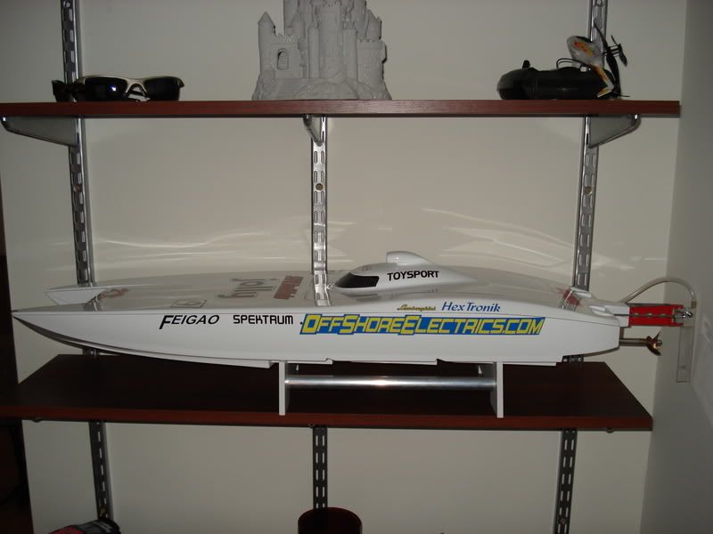

                      Did some testing today of my twin Jolly and even with 33% centre of gravity the porpoising and bouncing is real bad until she gets up to near full speed when she flattens out.
                      To move the c/g further forward will mean putting the batteries ( all 24 of them) up under the deck.
                      I am watching with interest how the Toysport version goes and how they solve this problem.
                      My surface drives are in the same relative position as the picture posted by Steven of the Toysport version, and am also running counter rotation with the props spinning inwards same as the picture.
                      I can angle my drives down about 1 degree if necessary but I cant see that small adjustment solving the violent porpoising.
                      I have built and raced several cats and none have needed the c/g to be further forward than 33%.
                      I'm scratching my head over this one !
                      Graham.

                        Changed the props to rotating outwards as suggested - no better.
                        Still porpoises like crazy. I even tried it with two cans of Coke jammed up in the sponsons to give a c/g of about 40% - just the same.
                        It was exciting opening the cans afterwards !
                        I think the next move is to angle the drives down to the max ( about 2 degrees ) and try some lifting props to lift the stern.
                        Still watching with interest to see how Toysport set up their twin version.
