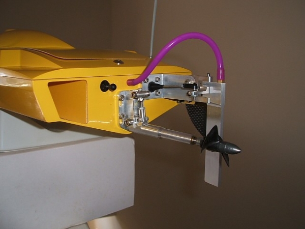

    How many cells do you want to run. Here are some photos of mine.
    http://forums.offshoreelectrics.com/...read.php?t=361
