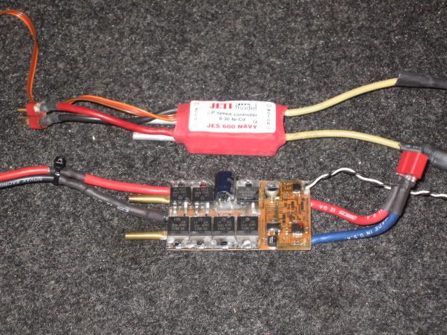

        Thanks for your input. Okay i'll share more details. So I have 3 routes i can go
        1. RC hydro's esc (not sure on the specs on this model maybe you can help me on that andy?)

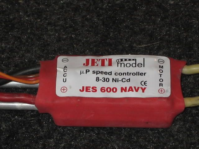

        2. Jeti 600 Navy esc 8-30 cells and 60 amp output.
        3. Traxxas evx-2 16.8 volts not sure on the ratings. It says rated at 180A but 30A Continous ? I have one of these right now that im not using but another option is running 2 of these.

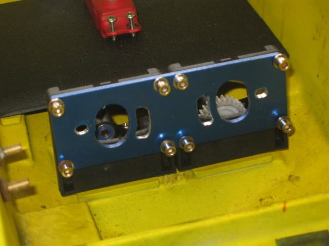

        I would like to wire the motors in parallel to increase output? After all thats the whole point of putting in bigger motors right? lol Let me know your thoughts on this. Also some mods to the boat are Octura 447's counter rotating, Graupner U Joints , Larger drive shaft tubes with bearings.
        I had to shave the motor plate out to get the mounting holes for the 775 motor
        • AndyKunz
          • Sep 2008
          • 1437

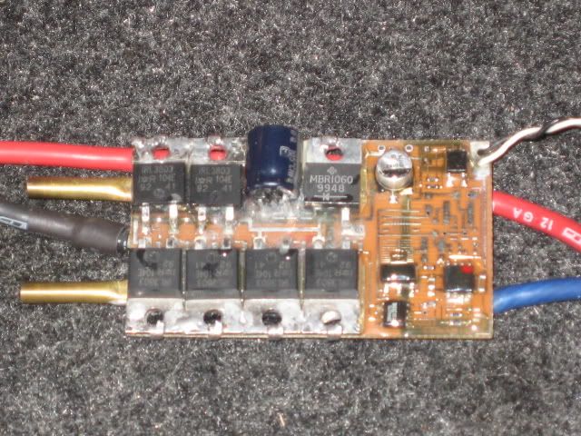

          That's one of the VERY early SC-3's (no solder mask), probably about 1997. It's for 6-15V, 90A.
          It's opto-isolated and will need a receiver pack to operate.
          It's neat to see my stuff that old and still in use!
