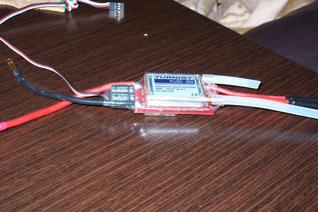

            My first ESC was aircraft :-) (Turnigy Plush 80A ~50$)
            I made watercooling plate by myself (copper + brass pipes + thermal conductive glue).
            No problem running 60A on my first 20" mono - 380L and cheap 5,3Ah lipo 7,4V
