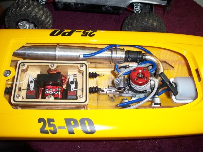

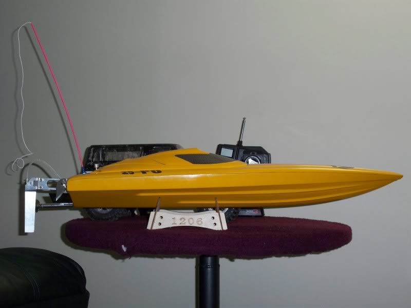

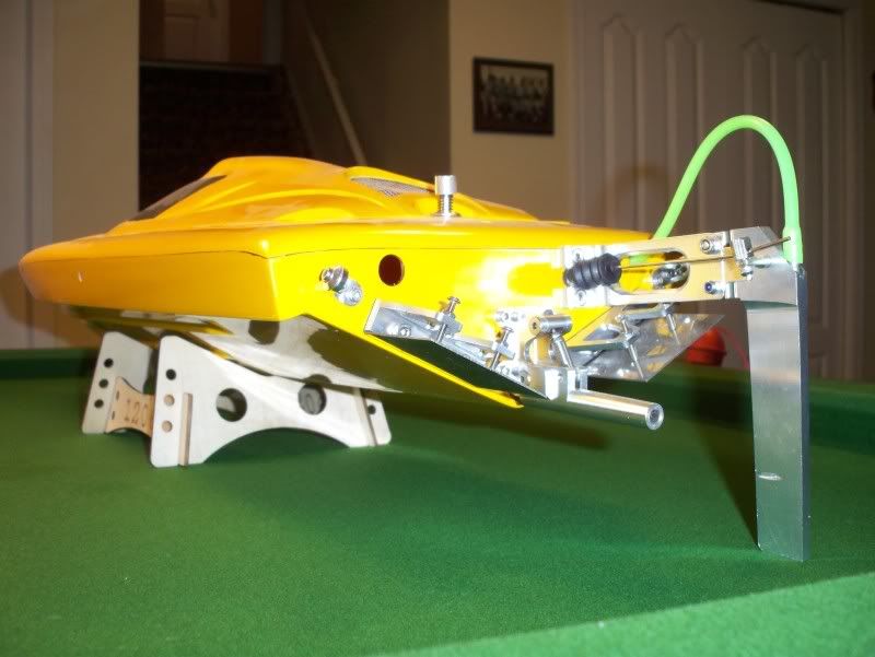

    So I'm converting a .25 nitro 33" deep vee into a brushless powered beast. I have Peter Zicha working on motor mounts and esc plates. Either a Fiago 580xl or a 15 series neu will be going in.
    This is the boat in question
    Now I've been looking at esc's on the store page here looking at the Etti and Castle esc's. However. the Higher the Amp rating the more Jam the esc has correct? So wouldn't the Etti with a 4-14 lipo S rating but with only 100amps be a dogg? The Castle 240 seems like a nice unit aswell but is there another product out there for around the same price or cheaper then the castle that takes the cake? I also was looking up the Turnigy escs. What I'm not picking up on is 180amp but only 6s limit, then others are 180amp and 80amp 12s limit. Can someone give me a hand with picking a esc out?

    That and now that I look... is 8s going to be just stupid in this hull? I like stupid fast, jump out of the water fun. Are the Fiago 580xls a good motor? Edit** The more I read online, the more I hear that this motor is really quite hit and miss. Now I really need help on picking a motor LOL This is going to be a play boat, but I like high speed runs. rippin around the ponds, lakes, etc. Maybe I'll join the local high power boating club lol.

      I would put a castle creations 240 lv and either a neu 1515 1y or a 1521 1.5d either motor on 4s 5000ma 30c or higher with a 445 to 447 prop is about the norm for that size boat it will be plenty fast enuff good luck
