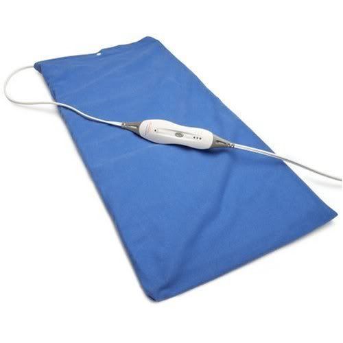

    Has anyone ever tried using a heating pad to warm lipos such as the one in the picture? I usually have a 120 power source at the pond and I was thinking about laying one of these on my pit table and folding the lipos in it before a race.

        Trini I use two of them.
        I lay the cells on one pad and cover them up with the other.
        I use the pads when the cell temp is below 70 degrees or so, and then just heat them to 80-90'F. The medium setting seems to be enough to get the job done (inside the trailer).
        Consider getting the pads with the automatic shut off.
