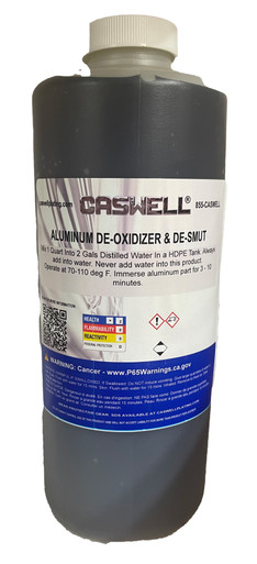

                Here is a quick link to kind of give you an idea. I DO NOT suggest buying this kit, the materials can be bought at the hardware store much much cheaper.
                Here is another article that gives good basic info:
