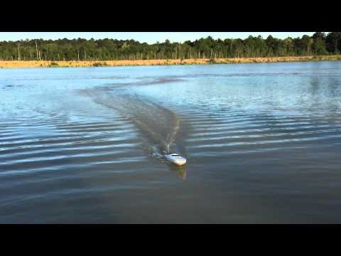

    There was a few of you guys that wanted to see the difference between a lehner and neu. I don't have matching kv motors so it's not a very fair comparison especially since the lehner is rated at a load (what kind of load and how much I don't know). The lehner is 1644kv and the neu is 1500kv.
    Short story on how this came about. Sold a seaking 180 to a member. Something was cutting out on him so he sent it back to me to check. I thee it in the mono with a neu 1527 to test it. I couldn't not post these vids because the boat ran quite well. All runs were on 6s. M445 prop first then a m447
    First run small prop 46.0mph

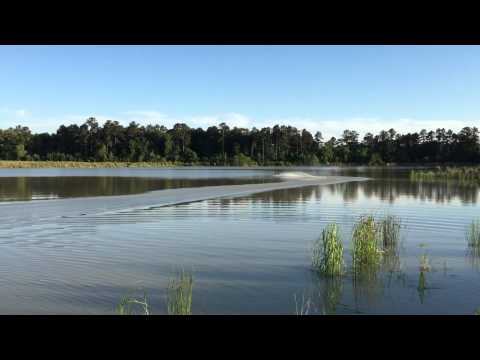

    Here's an m447. 51.2mph
      Here's my thoughts. The neu didn't break a sweat. I didn't log it but I'm sure it didn't pull near the Amps. It feels like it's not working as hard, basically comparing the two motors would be like the neu is a big block Chevy and the lehner is a high revving turbo charged small block.
      I think the neu could use more prop. I'm gonna try an x450 on it soon. This is a nice sport setup or a roundy round setup. Note: I had the smaller sized turn find on it, if I had appropriate sized one, it would have turned even better.

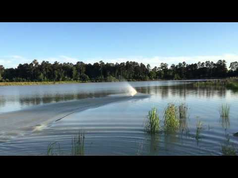

        Here is the beginning run with the m447 prop.

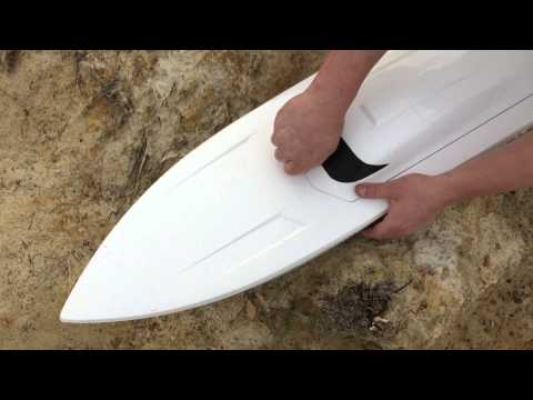

            Here's a 6s lehner video.
