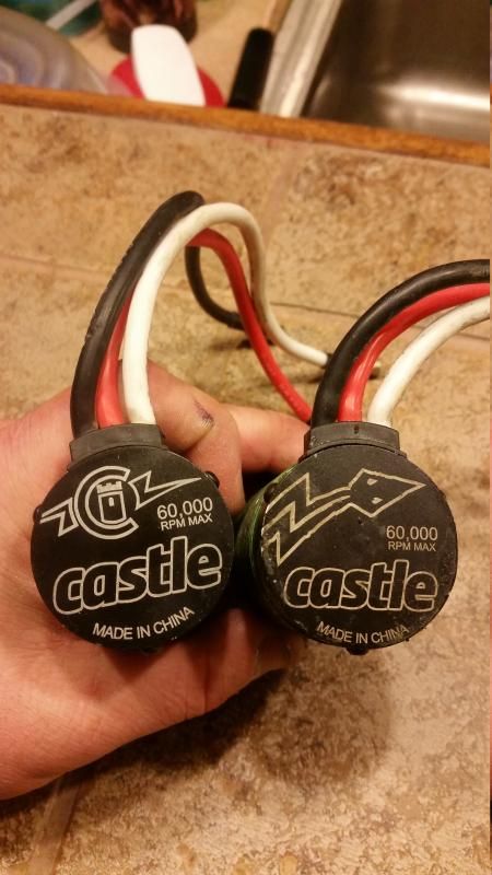

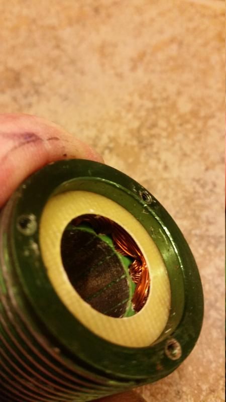

              If you guys can find a difference, be my guest....enjoy....

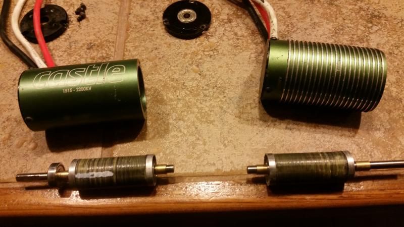

                And the ones that really mean something (both rotors were marked the same way and had the same putty on them to balance them)

                    No problem. Truth be told, my son was sleeping so I snuck his motor out his room and took it apart. But really what could he say...... I bought it! Lol
                    I could find no difference between the two. The ONLY thing I saw was on the finned motor, there was two curved washers to keep tension on the rotor. I've seen some motors have that and some not. Even the same name brand. A far as I can tell, they are identical.

                            The curved washers is all I could find different.

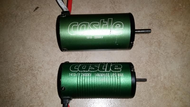

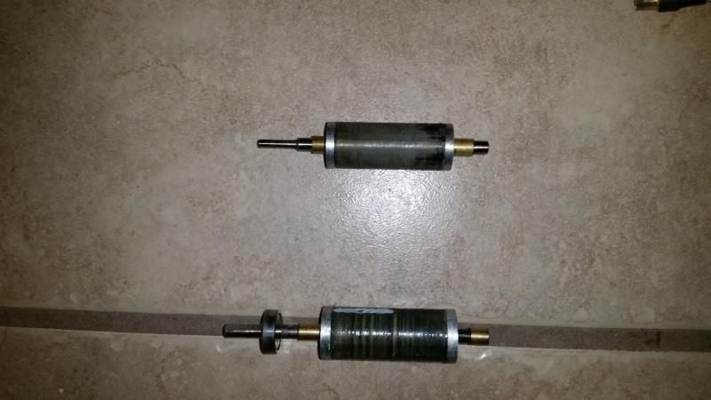

                              More interesting stuff. My son put a 1515 in one of his short course trucks. That motor kept shredding axles. So I let him use one of my 1415 motors. I've been told it has a 1515 rotor in it. Been told the rotors are the same size, they make the same power...etc.
                              Well from his perspective, he says the 1415 has a little less torque but more top end power. Fastest he got with the 1515 was 66mph, 1415 was 66mph the the tire popped. Lol. But even more interesting is I took them both apart to compare just now. The rotors are very close in size which explains the exceptional power the 1415 has..... take a look...
                              I think this pic makes the 1415 look the same size because of the angle. They arent...the 1415 is only a tad shorter tho...
