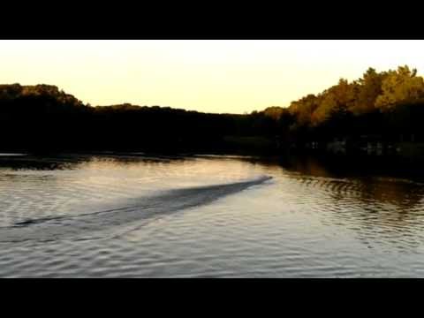

                This is with the X442.
                Motley Crew, Neu-Castle 1515 1Y 2200, 22 Volts, 180A ESC, Custom Motor Mount, .187 drive cable. Aero mod.
                Best 74.1 mph, Average 71 mph.

                  That is the same prop I have on my Daytona using the same motor as you but on 4s and I have not done much testing with it,
                  It just runs pretty good the way it is for now.
                  I like running the 3 blades with the mono's I have been running and testing,
                  They have less torque roll on the hulls and good top end speeds and ride smoother to.
                  And I also think they have less amp draw on the setup from the temp I am getting using them,
                  Compared to the M props so far.
