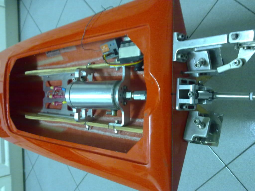

Hello guys...Looking for opinions from your part...
Have a Leopard LB5692/2Y wich has a kv of 1090.
I´m looking for an application for it, but need your opinions...
I love outriggers...have on for oval racing and one for SAW...Happy with both...The SAW version is powered by and Lehner 2250/5 and 6S1P 45C 5000mah Lipo battery.
The oval version has 41 inch and is powered by an Scorpion KH4035 800KV that i´m runnnig with 10S1P..is not running flawlessly becaus of compatibility issues between the schulze 32-20WK and the motor...for that issue i´m waiting for the YGE 160HV, but since it is a outrunner. is hould get a good speed and running time compromiss using this setup
I´m finalized 3 weeks ago mine DF 35,5 powered by a NEU1527 1.5D......Getting happier each day with it..jus have to dial a little bit with them in order to get the most of it, since it´s "overpowered"
Since i´m not a lover of catamarans......
I have 3 options, being one major factor that i like the same of building them, has driving it:
Option A - Use the leopard motor with 8S or 10S in a JAE 91/101 hull, wich in mine opninon would lead me to a lot of problems concerning this motor would need a 2P setup, wich would mean a heavier boat, and since it´s a low profile version i would assume it would submerge a lot, and would have to "get" room for a 10S2P setup...don´t know if it will work based on the 36 inch length version of the TUB....
Option B - making
a 1/8 scale hydro...would need to get plans,and room for electronics and hardware woudn´t be an issue..
Option C - In mine opinion, and for what i´m leaning out.....Making an F1 based on Kris Flynn plans with 41 to 43 inch...it would be awesome to have a F1 that size....major problem would be getting a rugged and reliable outdrive for so much power
Waiting for your opinions
Very Best Regards
