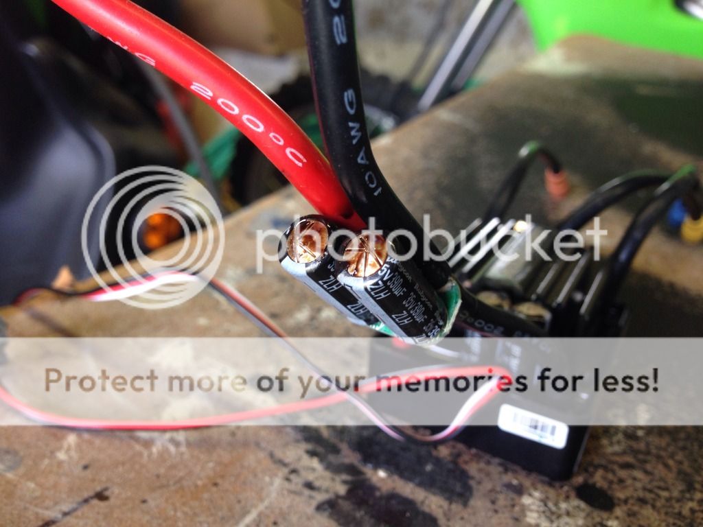

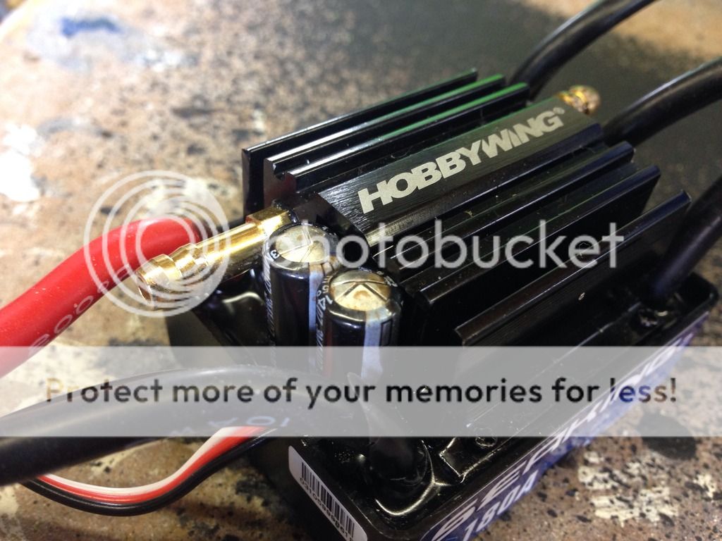

    Long story short my spartan ESC finally started giving me issues after a year, so a month ago I purchased a 180A v3 hobbywing from the OSE store. Then about 2 weeks ago I purchased a Rivercat hull from Travis and decided to use the ESC for that. Well I had to try it out Lol so Ive ran about 8 times with it in the spartan and possibly burnt it up today. Boat cut out after about 5 minutes, got it quick with my jetski and when I pulled the top off there was a very small amount of smoke. Capacitors look burnt or something. Motor timing was 3.75 degrees on stock castle motor. Am I out $120 or is there any warranty on these? Thanks

                Is the Castle motor a Y wind or a D wind? Best I know is Castle only does Y winds I think? If the motor is a Y wind and most likely is, the timing is way too low and should have been 10 to 15 degrees. The 3.5 timing cooked you're caps, kinda voids warranty imo but, try anyway.
                The caps are toast but, you may be able to sacrifice the esc. You would have to pull off the caps from the main unit with pliers making sure any leftover metal leads are remove and or insulated with some glue. Remove the caps from the power leads and add new ones, Rubycon ZL or ZLH caps from Steve at OSE. A Castle cap bank from OSE would be simplest. If you can find just a polarized cap of some kind in the 480uf, 35vdc rasnge first, solder in and bench tested before spending money on a cap bank, maybe it can be saved.

                      Awesome thanks a lot for the info I was not aware of the timing difference between a Y/D winding motor. So I can pull the caps from the actual speed controller body and seal that off, then pull the caps off the positive/negative wires and just solder in a castle cap bank? If I just cooked the caps could I possibly fix it with the cap bank? Also do I need to heat the caps up on the ESC or just grab with a pliers and give them a yank Lol? Thanks again I appreciate
                      • ray schrauwen
                        • 9475
                        If the esc is considered dead at this time yes, just pull off the caps with pliers from main unit, no heat or more can be damaged. Unsolder the caps from the main leads and toss out.
                        It would be cheapest to get one capacitor first to solder onto the leads to test the esc if it will still live before buying a whole cap bank.
                        Just make sure when you pull the caps of main board that you don't have any remaining wires that can short out. If it works, seal up the holes where caps were and solder in a nice cap bank. Don't waste more money than you have to.

                            What prop were you running? I have had the caps get really hot on my 180 also. Not like yours, but still really hot. Have since increased the motor and prop sizes and it has been fine. Weird. I try not to hammer the throttle as much now.
                            I don't believe the timing was the issue. I have ran 0 timing forever on castle y motors and never had an issue. They draw less amps with less timing, they just lose rpm. Just because Ys benefit from extra timing doesn't mean they have to have it to run right. This of course in my experience only.
