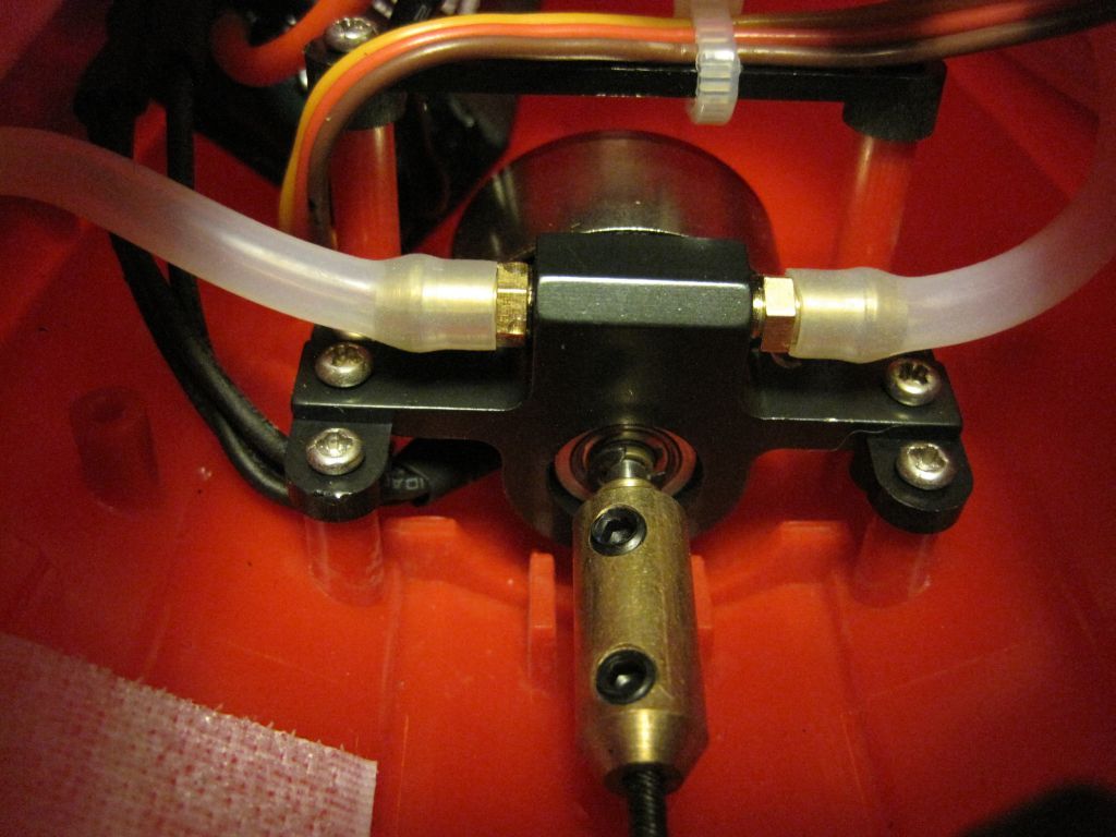

            What you mean this?!
            FYI the motor ran cool on the old ESC and drivetrain before the stock ESC blew. It now has a new ESC and Octura drivetrain. You didn't even read my last post did you?
            • Rumdog
              • 6453
              Yeah. That mount is what I mean. They don't do much for cooling. I'm willing to bet that the excessive heat is caused by your new drive setup.

                I had to ditch the new compression collet as it was too heavy and unbalanced. I drilled out my old brass collette to accomodate the larger .130 flexshaft as well as put some hot glue at the bottom of the motor so it mates with the plastic and vibrations are much less now.
                Old collette was only 7 grams, new one was 12.
                I'll restart ESC timing trials tommorrow.

                            Well removing the vibration means getting another motor, which means modifying the motor mount to take a standard outrunner. The vibration is there with just the original collette and has been there since the boat was stock. Even without the collette, the motor has minor vibration at certain points in the RPM range. It's not bad and doesn't persist throughout the entire RPM range. I guess I could try balancing the can, trying to determine what I could use that wouldn't fling off at 30K RPM....I guess I could use epoxy.
                            The existing motor mount is rather weak, which is why I've shored it up with hot-glue because the bottom of the motor mount is just free-hanging, and now it's at least mated to the hull. That alone has made a difference in vibration. I'll do a few short runs to make sure the heat problem is gone before I accept the hot glue as a long-term solution.
                            • martin
                              • 2887
                              Are you getting this vibration running the motor out of the water with no load on the motor. Outrunners will vibrate a lot more than inrunners if run with no load on the prop. Are you getting noticable vibration when the boat is in the water with load on the prop.
