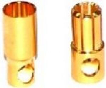

            EC5 dont go to motors. They're for batteries. Motors have bullet connectors. go order EC5 connectors and convert everything over to them by soldering them onto the batteries and ESC. Also order the proper size bullet connectors to the motor that match what came on the OSE raider. Which is 6mm.
            You can get them overnight from amazon usually if you dont want to wait. Hopefully you have a decent soldering station and good solder. such as Kester 63/47 .080. You need to have good solder for boats because they will desolder joints from sheer heat. Which is why you need to upgrade everything you have to EC5 and 6mm bullet.
            6mm bullets
            https://www.offshoreelectrics.com/pr...ose-6mm-bullet
            series cable
            https://www.amazon.com/Wmzjnljy-Conn...s%2C235&sr=8-5

                I think I misunderstood what you were saying in your last reply. With the link you provided on the 6mm bullets, are you saying I should cut off the 5mm and replace/solder with 6mm or are you saying that the linked 6mm bullets are an adapter between 5mm and 6mm? I cannot solder so for now I was hoping that there is an adapter that I can put between the 5mm motor and the 6mm ESC.

                  IDK if an adapter exists. In this hobby its a really good idea to get a soldering station.

                        The more adapters you use, the greater resistance you create from the additional connectors and wiring, causing things to get even hotter and desolder even easier
                        Soldering is a skill that is a must for any serious modeler, and there are tons of YT video tutorials to get you going. You want big bullets, and as few connectors as possible within the wiring
