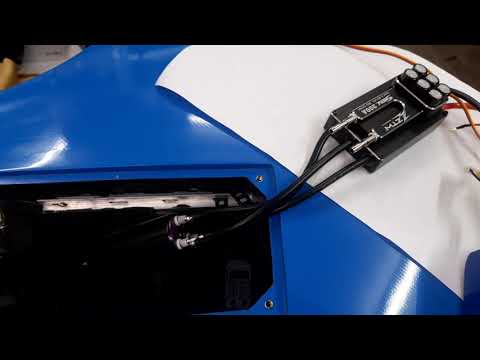

              I have an update on this ESC - not such a good one
              As you can see in the video above I ran the ESCs in a ~100mph setup. This requires certain lakes and during summertime we have people swimming, ... and only very few lakes where you can run really fast boats. Long story short: I did not run the boat for several month.
              When I wanted to run it this weekend it looked like the ESCs had forgotten the throttle calibration. Ok, repeat it and go.
              I had 2 runs that were just normal. The third one convinced me to replace these ESC and not to risk my material or even casualties by running them again.
              The boat just behaved strange, I did one slow circle of perhaps 15m to get my boat back and when I opened it there was smoke inside. Not a lot of smoke but some smoke. On the first view everything looked fine. On the second view I found the burned RX-cables as you can see in the attached picture.
              The setup in the boat was pretty simple:
              • Two separate drives, each having 6s LiPo
              • No connection between the LiPo, If one ESC fails and burns it can only kill one LiPo and not both.
              • As the ESC have BEC and 2 BEC in parallel might cause electrical oscillation I connected the RX-cable using a Y-connector that does not connect the plus on the RX-side. I use a separate RX-batterie. In high power application this makes sense anyway.
              The damage is also described pretty quickly:
              The minus-wires going to the RX are burned, plus and impulse are fine, the burned wires end in the Y-connector. The minus-wires of the Y-connector on ESC-side are also fried, on RX-side the wire is completely fine. This tells us where the uncontrolled current flow was. It was going from ESC to ESC on the RX-minus-wires. Kind of a ground-loop obviously.
              Analysis today: I replaced the RX-wires and both ESC work fine. I just tested one at the time. The BEC also works fine, at least on 2s as 2s was the batterie I just had to hand.

              2. Bringing a motor to high rpm the ESC causes high EMC disturbance. This dusturbance is so high, it caused rushing noises when recording videos with my Samsung smartphone. As I had the firmware-issue I discussed this with my vendor using WhatsApp and videos. This is why I found out about the EMC-disturbance. ZTW claims that the ESC fulfills CE and RoHS. It would be interesting whether that is true
                You can see the strange startup with the old firmware and the disturbance of soundrecording in this video, talking is in German language though.
              3. The ground-loop is the next topic. It happens by chance. As I had no intended connection between the two 6s LiPo I expect it to be a switching-issue which can be no problem sometimes but it can be a problem like I experienced without you knowing it before.
                What I am doing now is brainstorming of an electrical engineer but when the ESC operate synchronously (synchronous switching of the FET) I would expect to have no (only little) current flowing, which would be no problem. If switching would be inverse orientation there might be high current flow due to inverse voltage ripple that could burn wires that are only dimensioned for signals.
