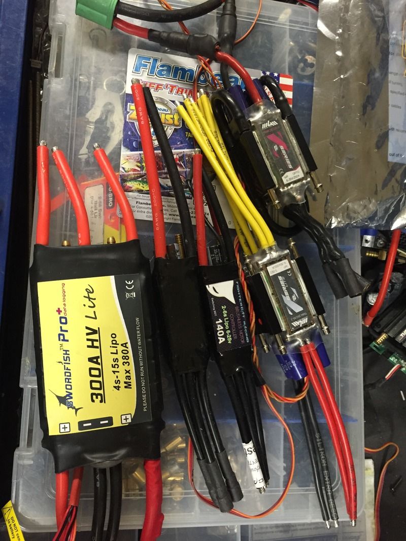

              Yes it will but they are a little big in size. One of my favorite controllers tho.
              • dmitry100
                • Mar 2015
                • 1264
                The Lite's are not big at all ... well, depends on the hull size of course... Given their low-profile (flatness) size they fit just about anywhere.
                  Ummm, I disagree. Included in the pic is the 25035 series mgms he was referring to. They are fairly flat but they are very wide and long.
                    If you like I have a 240 castle I can compare. Measure or whatever. I have some sf220's to compare. Seaking 180. Etc if you need a better idea. Any idea of the amps you were pulling? We might be able to find you something else although a controller that will handle 10s is few and far between. I think you'd be better by going up in kv and down to 8s and you'll have many many more esc options available. If you have the 240's in the metal cases that look like the 240 that handles 8s, I have an idea for you that would be cheaper.
