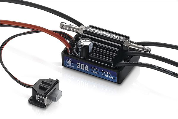

    I'm thinking, a small cat, with a small outboard (will turn much better at very low speeds than a racing style inboard and rudder) as well as take up less space inside the hull, leaving room for the fuel cell. But, I still think this combo will pull way more amps than those Tamiya connectors will handle. You'd either want to wire that fuel cell controller in parallel so the majority of the current could bypass the controller, or get a lower kv rated motor that would bolt up to the outboard unit.
    https://www.offshoreelectrics.com/pr...prod=df-Cat-29
    https://www.offshoreelectrics.com/pr...prod=ose-80980
    https://www.offshoreelectrics.com/pr...seaking-30a-v3
