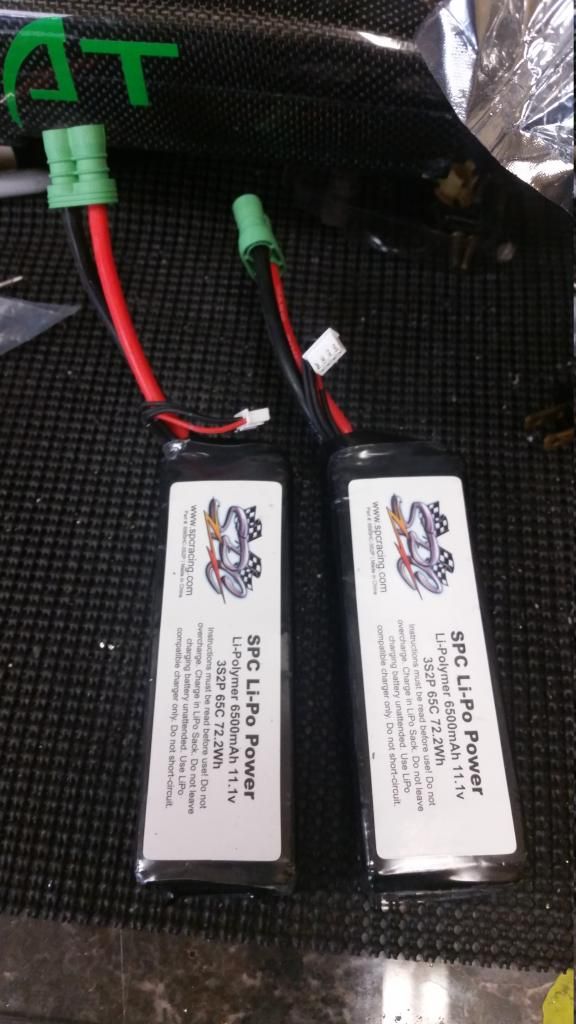

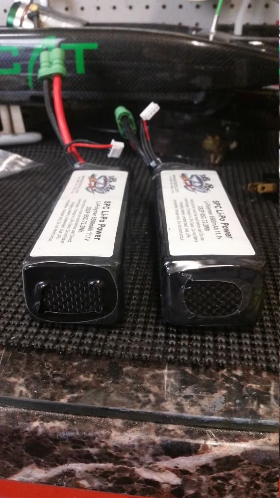

                          Has anyone converted hard packs to soft packs? I do most of my batteries. More compact and lighter. I do one layer of black, foam in the end on the wire side, carbon plate on the bottom side, both as protection in case they are dropped. Then the label is heated up on the case and transferred to the black shrink. Then clear shrink over that so they stay looking new.

                            thanks
                            and where do you get the colored heat shrink?
                            I use clear on all my packs to help keep them looking new longer
