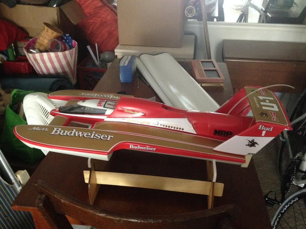

    After 20+ Years, I'm back in... MRP Miss Budweiser, battery options/suggestions???
    I was into Nitro Outboard Tunnels when I was a kid and have recently been wanting another boat. So I scored a basically new MRP Miss Budweiser, had my eyes on them since they were introduced. But with all the new technology out there I am a little clueless on battery and charger selection. I would like to get this beauty in the water ASAP. I had also done my fair share of ON & Off road RC car racing and do recognize some battery and charger brands. Research suggests 7.2v 6C batteries and the boat has Tamyia plugs and the standard electrics.
    I am going to be getting into some newer electric aircraft in the near future,they run brushless and lipo's, so I would like to get a multipurpose charger if need be. I would also like something I can charge from home and in the field. But don't know if I can run lipo's in this particular boat.
    I don't want to break the bank on any of this stuff, but I don't want to waste my money on garbage either. I am not opposed to used stuff either if any of you have something that might work, please let me know.
    Any suggestions would be greatly appreciated and I'm diggin the forum here thus far!

      Hi,
      Nice scale looking Hydro you have there.

        I also had the same boat when I first got into electric (before brushless was the in thing)
        I ended up having to split the hull apart (top from bottom) as there was a web for support that went across the boat that made it imposible to move the battery far enough ahead so I could cut it out to get the boat to balance right
        There is very little room to get a lipo in past the motor on each side but it can be done
        You will only be able to get a 2S lipo on each side
        I have some pictures but did not take any when it was split apart

                    Really cool boat

                      Thanks, wish it worked as good as it looks, lol...
