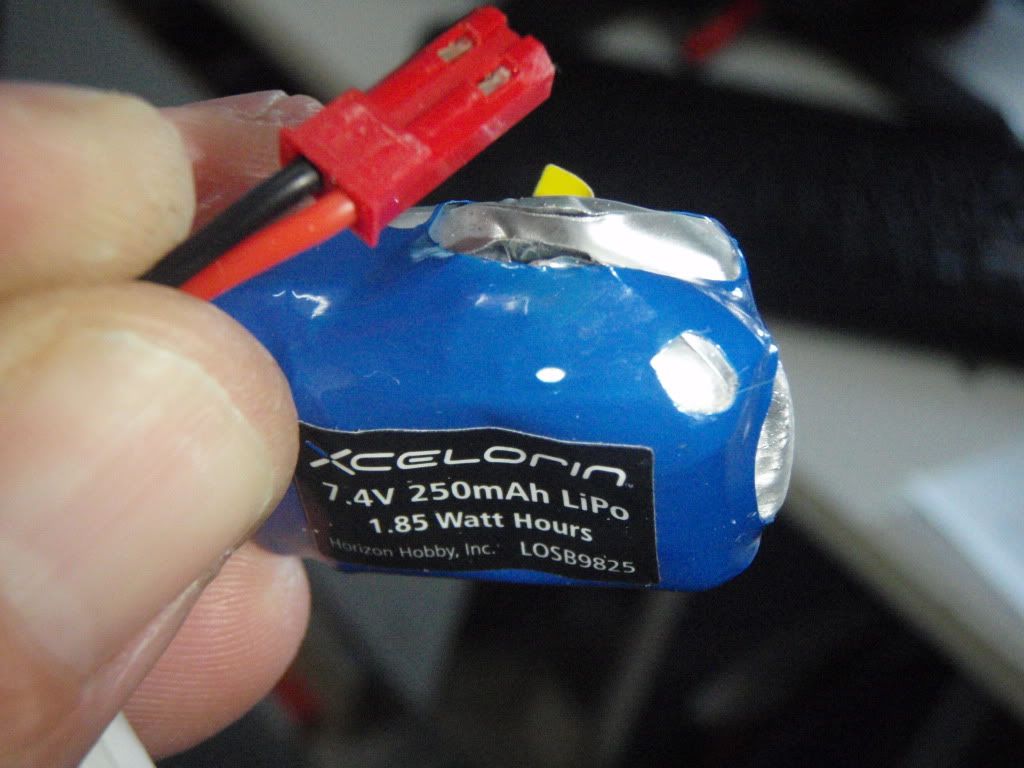

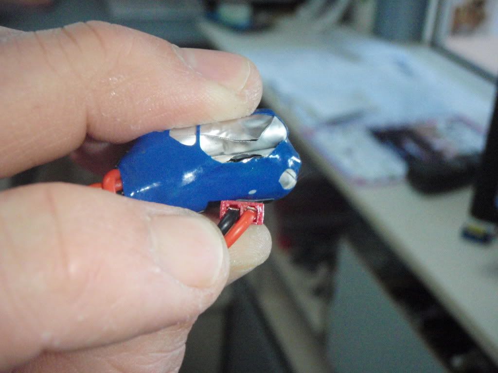

    Hi, I thought I'd share the experience I had today. After waiting nearly a month for them to arrive (the losb9825 s) I took them out of the packet, removed the losi connector and attached a jst2 connector as I have with lots of batteries b4 and then went to charge them on my Hitech x4 charger. I connected each lipo into an octopus connector that then goes into the charger, same as I connect all my other lipo's (I always check polarity) and even with the charger not delivering any power to them I noticed a strange sound comming from the first lipo I connected, I went to feel it and it went poof so I quickly unpluged both leads from the charger and threw them to the ground. I checked the 2nd lipo now that it was on the ground and I could see and feel the heat in both the wires and the lipo, the first lipo had a big blow out, I think I unplugged the 2nd one just in time, it's very swallen. At first I thought that maybe I am supposed to have charged them through the balance plug but after doing some research on the net and speaking with the Australian distributor it seems this is not the case, he say's you can charge them with either lead.
    I took some pic's of my charging set up and in one of them I am charging a 180mAh losi lipo with the exact connections that I used with the 250mAh blow out and Im also charging a NiMH with the same connections used.

        it did this with no current going to the batteries at all, I'd just plugged them into the same connections that I'd been charging other lipo's with all morning and be I pressed the start button this happened. I'm stumped, I checked the polarity be plugging and this occured, the Xcelorbombs just made a whistle, got real hot real quick and as I was pulling out the leads to the charger, one lipo blew out the sides.

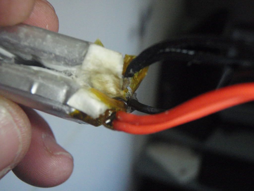

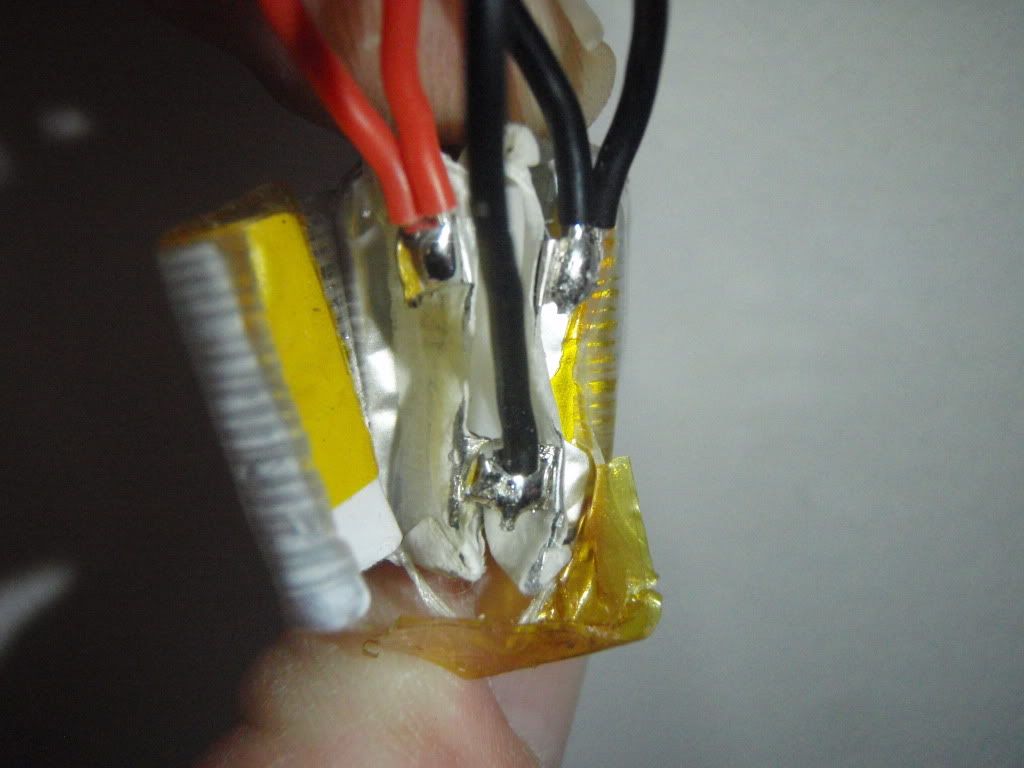

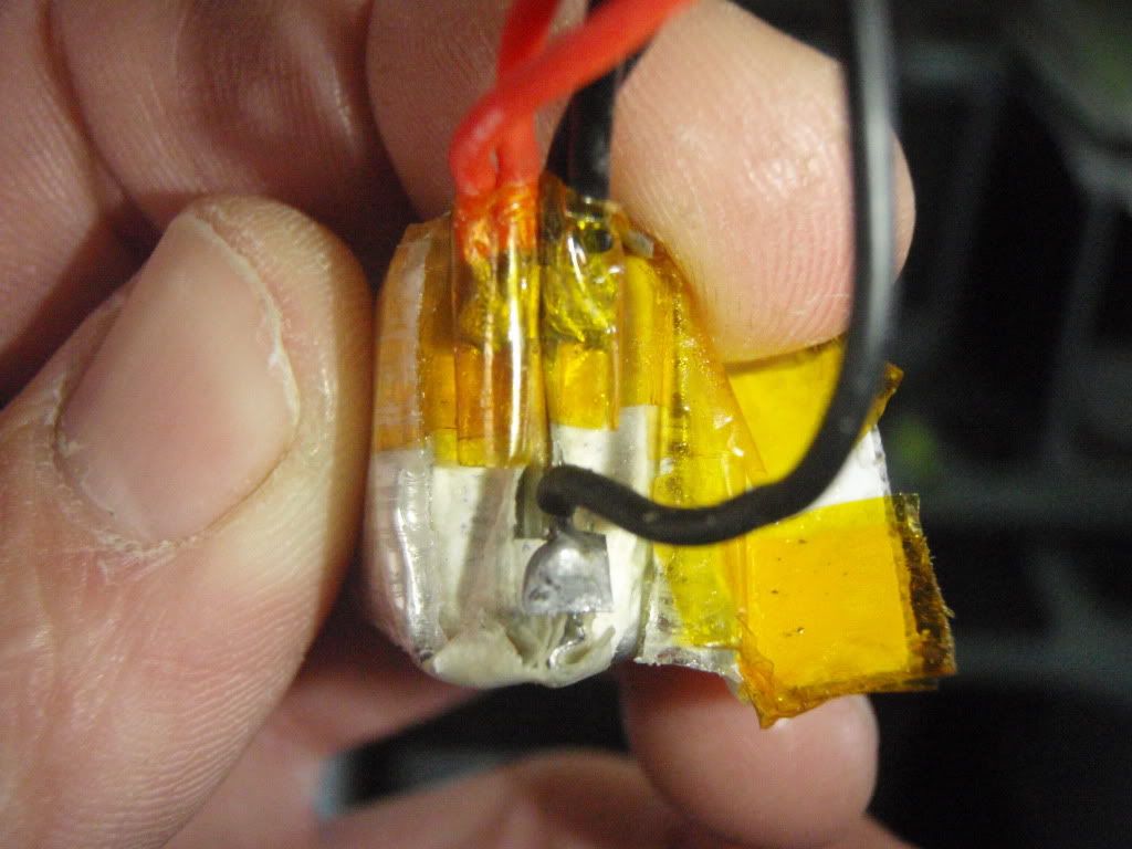

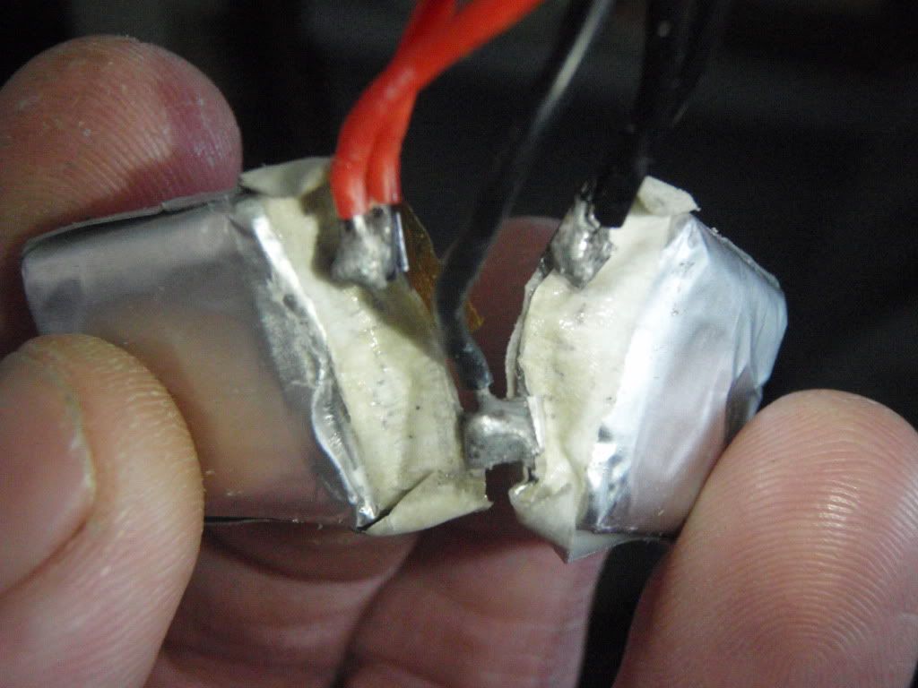

                    here's some pic's of the internals of both batteries, I dunno, these are the first lipo's I've opened up, do they look alright to you??
                    "Gimmy Toyz for FUN"
                    • drwayne
                      • May 2008
                      • 2981
                      ok.. balance plug [Bl.Bl.Red] is [gnd,3.7,7.4]
                      Id still check polarity over the wires
                      rare but not impossible for dead/dud cells.
                      W
