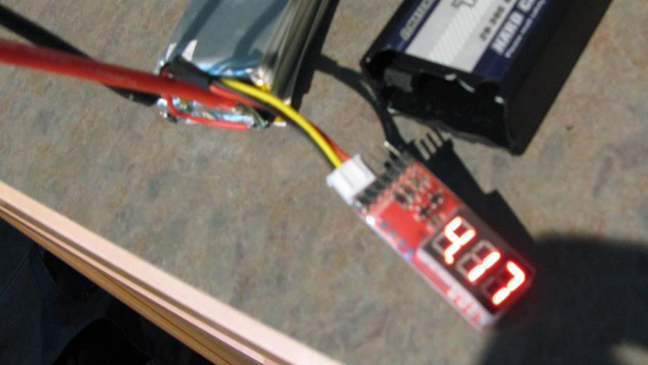

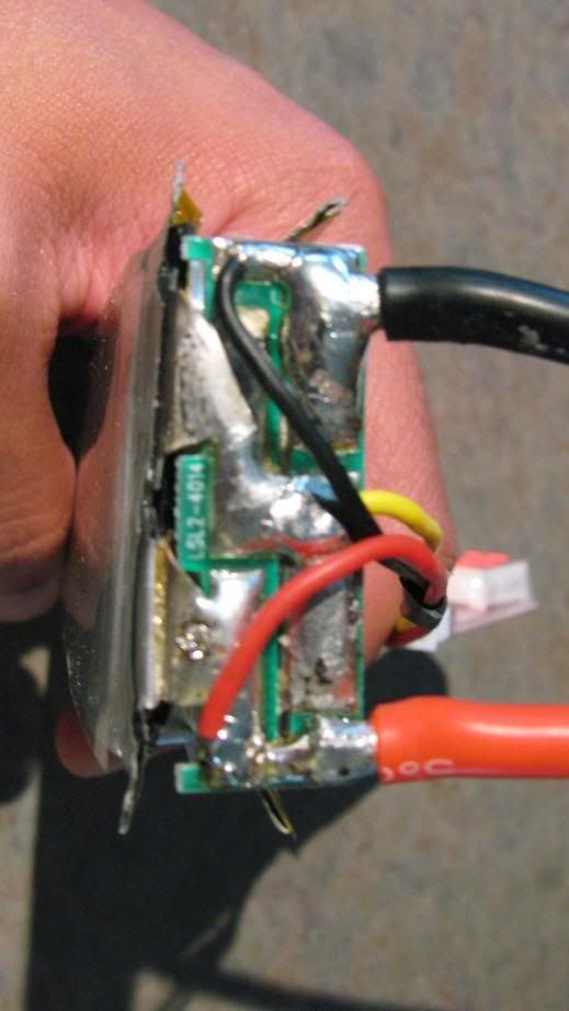

          Well I opened it up and here she is....looks like there's no loose soldering points...I checked each cell and one is sitting at 4.17V the other is at 4.18V. So I tried playing with the wires just to see if I could get a spark...nada nothing...BUT
          when I tried connecting some wires to the PCB where the wires terminate...I got the infamous electrical *CRACK*...scared the beejesuz outta me! LOL
          So it looks like the pos/neg wires are bad....is it possible for wires to go bad?

              I don't think its the dean connectors...and I don't have a voltmeter to measure the voltage across the solder points...but when I tested it by touching it with a couple of 5.5mm bullets...that's when it gave the big *CRACK*
              What I'll most likely do is unsolder the old wires and put new ones on to see if that works, because like I said earlier...I'm able to charge it and balance it through the balance connector....weird

                      soldered on new wires....we're back in BUSINESS!!!
