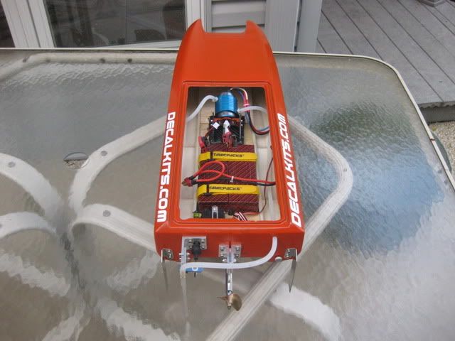

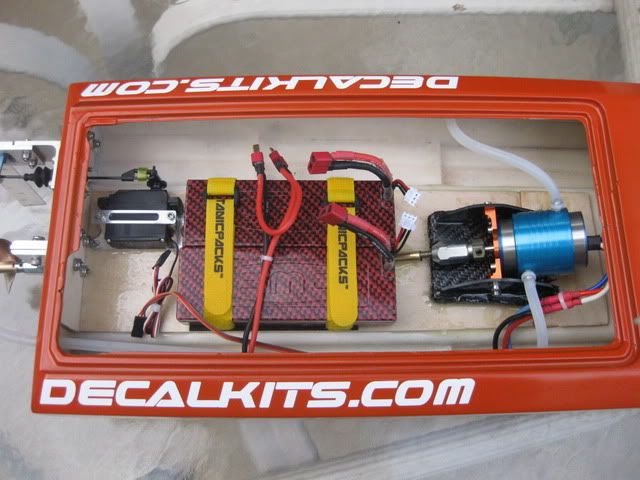

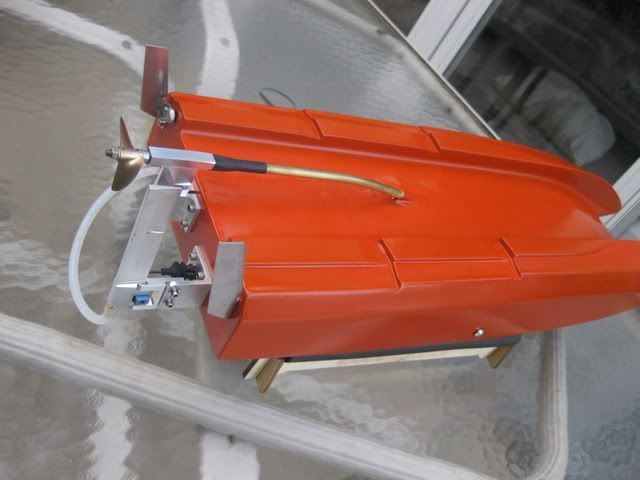

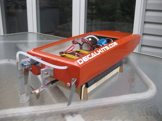

    Here's what I got done last night. Iv ran it 2 times so far, the first run
    was not very good, the Octura drive dog nut was loose and the prop
    slipped when it went full throttle.
    So the second run was a bit better, Not near as fast as the SV27 w/12l, but
    I can say this... No outdrive steering makes me happy! Boat handles worlds
    apart from the stock bj26.
    Id say its faster than the original setup, maybe 39-40mph.

    Tear off those turn fins and it'll handle even better. They totally work against each other in tight turns, being that both are alway in the water on a cat.

              try to leave a .150 gap between your strut and drive dog. it may be binding.
              • nate
                • 1652
                Yeps, It pulled it self tight against the strut and broke loose, it was fine before I ran it the first time...So it must have pulled tight..hmm
