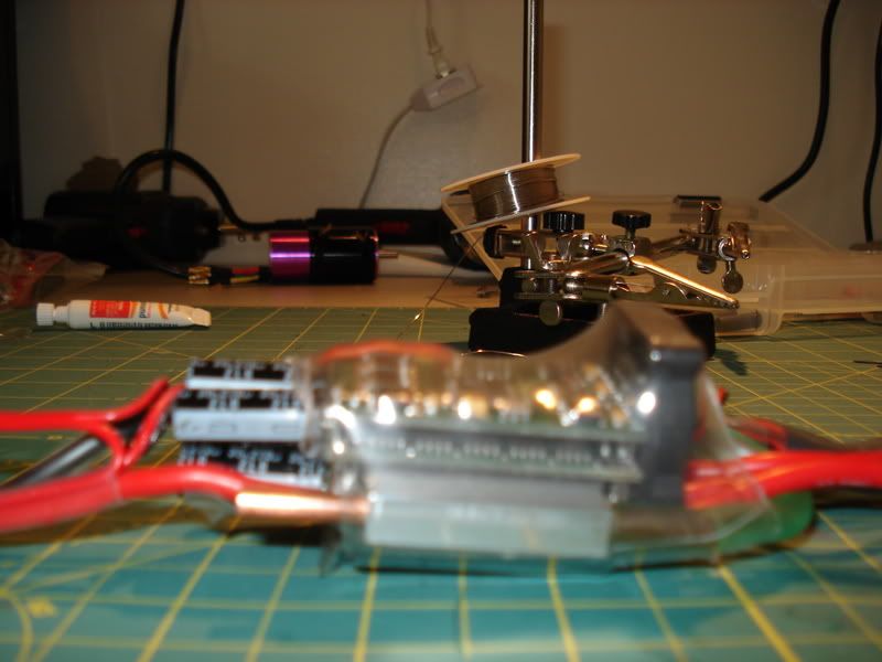

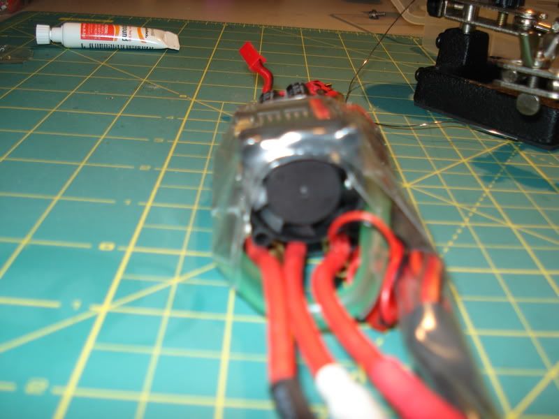

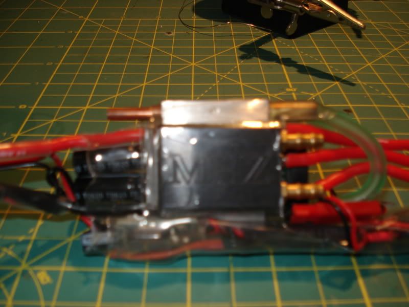

                            Well I made it out to my bench today. I still don't believe it myself. I may not be done yet either. So I took my hex apart and added some proper cooling. With 16 cells and the 11XL I am going to be drwaing some amps. This time I did it right. I removed the aluminum spacers from in between the inboard fets. I took a set of OSE cooling plates, used to capton thermal tape, slid them through opsite sides of the esc and the fit perfect. I put an MHZ water cooling block on the top fets. For the lower fets I removed the spacer, and installed a fan to blow across them and move the heat out of the shrink wrap. The S-BEC is shrink wrapped up in the package also. I now have to go to MHZ and het one of the carbon fiber flush mount 0 drag dual 4mm water intakes. Im going to install in on the verry back of the right sponsen. This way the OSE plates, MHZ block and motor all all independant. In case of a clog I dont blow the whole system. I think I may go back out and install the motor and start on the electrics tonight.

                              looks good....be impossibe to overheat it now...
