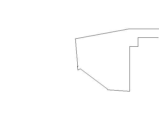

            Sketches are attached to show what I mean
            Which is the prefered sponson profile and why?
            I will design and build another cat, I want to know why I am including features.

                  Length to beam Varies for the intended use a wider hull puts the CoG at a lower angle from the ride surfaces which makes it more stable and able to corner faster, a narrower one has less frontal area and thus lower aerodynamic drag for a given drag coefficient, I run round an oval and am concerned by the lap time not the speed down the straight and I favour hulls in the 2-2.5:1 range, if you an oval but are concerned by the speed down the straight and don't care about the laptimes then a hull in the 3-3.5:1 range will be better for you.
                  Deadrise A higher deadrise angle has less lift so it cuts through waves better and can handle rougher water, but because it has less lift you need wetted area for a given effective boat weight and speed which slows you down.
                  Ride pads Ride pads try to avoid the deadrise compromise by having a small low deadrise area which is efficient to plane on at high speed but giving a high deadrise area to cut through waves which will drop into the water if you slow down for rough water.
                  Steps I don't know enough about steps to comment really, I have only made 1 stepped cat, I gave it "long steps" which seem to seem to have affected its cornering ability compared to my ustepped hulls, ones I'm building at the moment still have the long steps but at a much lower angle, 2deg instead of 5deg, it remains to be seen if this helps, I have seen some hulls that look like the "vented" type but when you put them on a straight edge have a very small amount of the "long step" as well, I don't foresee see plain "vented" types helping the top speed any over unstepped sponsons and unstepped sponsons should go round corners best.
                  Tunnel depth If a wave hits the tunnel roof it will create a large amount of lift that the boat is not designed for which will lead to unpredictable(depending on where it hits) and potentially disastrous results so you want the tunnel clear of any waves that you are liable to run in, I have cats with high deadrise and high tunnels for rough water and low tunnels and low deadrise for smooth water, best to have it as low/shallow as you can for the water you will run in as a higher tunnel will raise the CoG and lower the potential cornering speed and also make the boat taller than it needs to be, giving it more frontal area and increasing its aerodynamic drag for a given drag coefficient slowing you down on the straight.
                  Strut depth All my cats have ended up with the bottom of the strut a little above the bottom of the hull, higher up unloads the prop giving more RPM and a little more speed and can allow you to pitch up the prop getting your load back and a substantial speed increase, too high can result in excess cavitation, excess propwalk and even hooking.
                  Length Measure from the sponson tips to where the sponsons leave contact with the water whilst on the plane at the stern. The extension at the back is just to close the air behind the boat cleanly, it lowers the aerodynamic drag coefficient reducing the drag and increasing the speed for a given frontal area, I don't know what they call it in the marine world but in the context of bullets it would be called a semi boat tail,
                  Bottoms I believe that any medium to high deadrise area needs at least a spray rail at the top of it to stop the water climbing the freeboard, if you fit spray rails to an area that is too low in deadrise it may touch the water surface increasing the drag. I fitted turned down spray rails years ago to a glass hull that barely had them it ran so much cleaner it looked like it had slowed down but the lap times decreased. At the moment my bottoms are looking something like this:-
                  NB: The aerodynamic compromises are skewed for us in comparison to full size boats, halving the aero drag would make a LOT less proportional difference to our top speed at 60mph than it would to a turbine offshore at 200mph.

                      • Simon.O.
                        • Oct 2007
                        • 1521
                        Paul.
                        That is the most comprehinsive answer I have EVER seen to one of my questions.
                        Thank you big time for the effort that you put in there, it is pretty much all the info I am after. I will copy and print that answer and put it in my tech folder.
