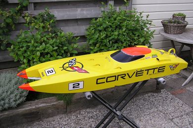

                      Checkout the Maxcat wood kit
                      The Maxcat big for zenoah powerFormers for the big cat from MaxcorvetteSpecs:lenght :1450mmBeam : 410mmPower : zenoah 26 No stringers or sheeting added no drawing But it is very easy and the cat does extremely well The Set contains a radio box Now with GFK Cowl/Hatch 6mm parts are joined with glass from 2x3mm ply Check
