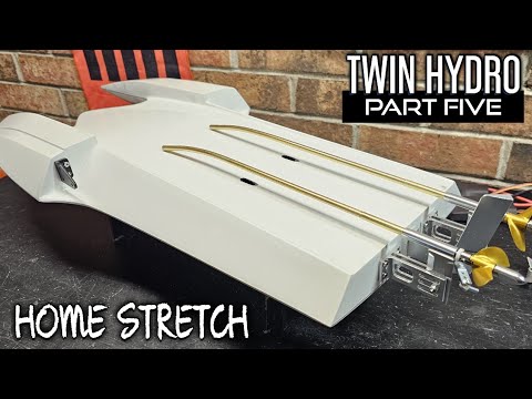

    The .130 cable is iffy for strength imo. It's worth a try since you have it.
    If you decide to try it I would mount the motors more forward. Components need to be laid out and latr installed so the center of gravity is approx an inch or three behind the sponsons...
    what struts did you order since the strut Inner diameter may not match your stuffing tubes? Are you using Teflon inner liner?

      haven't ordered them yet as not sure what I need and I forgot

        What are you using for a turn Fin?

          Has no fin. If he does a twin and only does saw's no real need. IF he wants to turn well he needs one.
          Glad you forgot Erick!
          what is brass tube diameter?

            It's a 1/4 inch OD now but will need to replace it with a longer one so can change it to a different bigger one and add a bigger flex cable too.
            What turn fin should I get?

              Also what flex tube size and tubbing will be best for my set up?

                  If you use 1/4" OD tubing it can handle both 0.150" cable or 3/16" flex cables. Your choice either will work. You will need new couplers as well.
                  Speedmaster struts are 1/4" ID so the match up best. TFL struts are metric.
