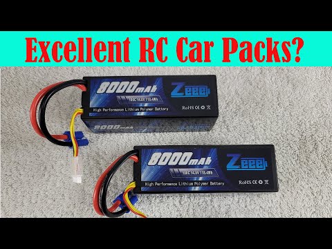

                        Do you have a data log? I bet you're voltage is sagging to under 3.4v pretty quick. that would be my guess as to why the math isnt adding up. Try to some SMC HV packs.
                        • mmars89
                          • Jun 2021
                          • 64
                          I do not have any logs, the SeaKings are pretty basic and I didn't put any sort of power analysis components in this build to keep costs down. I agree with you 100 percent though. I'm actually in the process of ordering new packs today, I think that is my bottleneck. I have LVC set to 3.4v and it has never cut out during a run, but it has to be very close. Thanks for the suggestion, I have heard good things about those, I'm going to look into getting a couple. I know a lot of people question the Zeee packs, and I'm starting to be one of them. I would think those ESC's and motors would be pulling the extra current if it were available, like I said, I expected way more heat a lot sooner, gotta be starved for power.
                          Thanks!
                          • Bande1
                            • Mar 2023
                            • 677
                            Thanks!
                            all these budget packs are good for around 15c. 20c pushing it. I know all my amazon specials behave the exact same as these Zeee in the video as well.
                            • mmars89
                              • Jun 2021
                              • 64
                              Thanks for that, makes sense. I've found very similar information on the Zeee's. And good to know about the other amazon brands, nothing looked appealing that I could find on there.
