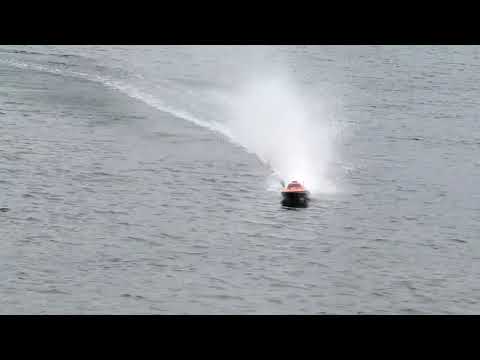

      Help needed, is it running wet?
      I spent a lot of time testing to get the right prop for the Invincible Razor custom build and now that I'm running it for fun, I'm noticing more that it probably needs further setup work.
      Here is the video over 2 days running it with the same setup, just different water conditions. I have not adjusted the stinger yet and I can shift the batteries back to get the CoG to about 26% compared to the 28% it's running at during these clips. Should I add positive angle to the stinger to get the bow higher? Or is this running well enough for just playing around at the lake and not racing?
      As mentioned in the earlier posts, it's two 3-cell LiPos for 6S total, a Leopard 4082 1250kv motor, 150A ESC and a sharpened and balanced Octura x447 prop.
      Motor and ESC temps stay under 90F and the batteries were just over 100F both days.
      Thanks in advance for any advice! I added a link to the video but also embedded it here, so one should work.

        From watching your latest video it does look a little bit wet for smooth water situations. Three things will loosen it up and potentially allow it to run faster. Put the batteries farther back, raise the stinger angel, OR raise the angle of the cavation plates. From photo # 4 in post # 6 I really can't see them that well but from what I can see they look like they could be low.
        They should not be flush with the bottom of the hull, but be about 1/16"
        above the bottom. If not they can cause a lot of drag, but with trail and
        error adjusting they can control the ride attitude of the hull as much as
        either of the other two methods. It also looks like you run in some pretty choppy waters, and for that you are probably right where you want to be.
        Loose trimmed out fast settings are for smooth water and no or very light wind. Run that way in rough water or windy conditions and you will be
        up side down fast and often. NO FUN.

          Definitely drag issues at the transom. As Pancho said raise the height of the trim tabs 1-2mm, and get rid of that extra water pickup. That alone will cause the boat to run wet. The single pickup from the rudder is sufficient cooling. Run through the esc first, through the motor and out. You will then find your cog at 28% to be loose, and will want to be able to adjust it to up to 35% for rough water running. The boat is light in the nose which can be seen when it bounces off small waves, it is just the tabs and pick up drag making it run wet.

            I originally had the trim tabs set approximately 1 to 1.5mm up from the bottom of the hull and parallel, so zero degrees angle. Based on your guys' recommendations, I made some changes. First, I was going to just remove the trim tabs but chickened out. Instead, I slotted the holes in the trim tab plates so I could really get them raised. For the one run I got in this weekend, I had them parallel to the bottom but they are 3 to 4mm up from the bottom (I assume that's a pretty good indication I may not even need them, correct?). I also raised the extra water pickup (haven't removed it ... yet). I kept the stinger at zero degrees angle and the same height from the last run and kept the CoG at about 28% again. One change at a time right!
            With the trim tab change and the water pickup adjustment, it ran drier and overall handled better. I was also happily surprised to see that I gained 4mph [6.5kph]
            When I get more time, I will also play with the battery placement and stinger angle to see what else this boat has in it!
            Thank you for the advice!

                boat is running well in the video i watched (first one) you should be able to get higher top speeds though .1250 kv is not alot .your going to need a big prop . i spin a x447 or a cnc x448 on my pursuit with a 1600kv motor on 6s and i get speeds just above 60mph .comes in with motor under 120 degrees ,esc too
                nice build .i dont boat much anymore but i enjoyed your video .carry on
                ps- yes your boat is running too wet .you need to get the hull up out the water more .try raising the stinger more .
