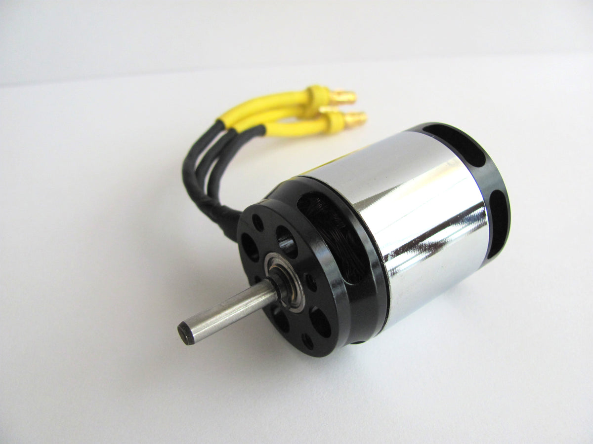

        Hydrospeed is a small ABS hull, a 3S setup should be fine with a 450H size outrunner motor (3300-3500kV)
        Motor :

            Thanks for your your input... that 450/500 motor looks good and at a good price too.
